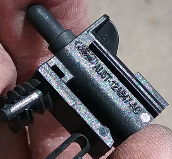

I did have one issue pop up. My outside temp is no longer reading properly. It's trying to tell me it's almost 60 degrees when it's below freezing outside. Since I just got the car, I'm not quite ready to be doing things like pulling the bumper off to manually reset the Ambient air sensor.
I do have access to the ForScan app (I used it with my old focus to do some engine tuning when a new air intake made it run rough), so if it's something I can fix in there, I can always fix it in there.
Just don't have the fun I had back when.
The ambient temp sensor is to be found by removing the front left headlight assembly - two bolts, one plastic trim screw and the connector from it to the harness - a gentle lift (observe for the rear bolt has an alignment tab to keep it in place) and slight twist turn, you'll see a lot of open air for some air intake ideas and the ambient temp sensor is on the radiator front shroud, the front shroud that collects the air going thru into the nose.
If you know where the air snorkel is, then the sensor is right next to and just below it - on that front shroud.
Looks like this once it's off it's connector...
You may need a new one - for if it's "nose" is cracked - that will cause the errant readings - kind of turns it into a humidity reader than a temp reading - salt and dirt does that to it.
