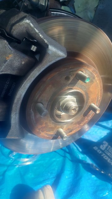

Brakes, er no - but there is a thread that might give you some direction as to how to determine the surging effort.
