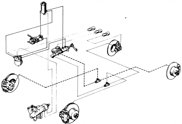

Brakes (The hydraulic side) are two redundant systems operate in pairs of opposite corners - so one system works Front Disc and opposite side Drum (Or Disc) - so does the other system.
If one of these systems is contaminated, with Debris or the pads of the Disc or Drums are not evenly worn, this indicates the Brake system needs service - soon - and if not inspected and corrected - can cause a crash from loss of control in braking.
This may mean brake lines are contaminated or damaged or the caliper and piston system is worn, or pads thickness is too thin and have reached the end of their service life. The Parking Brake is the mechanical lever system for Rear Drums/Disc but also can - if too tight in adjustment - force the pistons to retain pressure in the lines causing the front calipers to drag also - creating an unstable condition which should be investigated and corrected as soon as possible.
