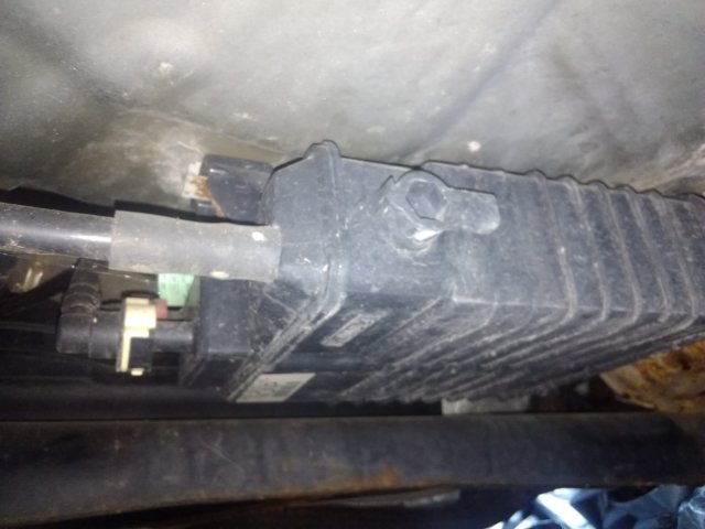

You are probably experiencing a failure of the fuel vapor cannister purge valve. This valve senses an increase in the vapor pressure of the fuel system. In response to either a temperature change or the introduction of more fuel being added, this valve opens up a path for fuel vapors to be pushed into the charcoal cannister that is located just behind the fuel tank (and visible. It's mounted to a bracket under the spare tire well). Be very careful when working on or near this cannister! The hoses must not be damaged when handling. The purge valve mounts to the cannister. This component is a critical evaporative emission control device.As such, it's expensive. Several hundred dollars just for the cannister and valve.
The slow fill rate is caused by the fuel going in the tank meeting resistance from those vapors with no place to go.
