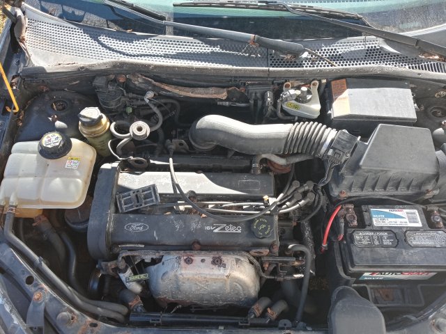

The big issue with the Focus Zetec that I can see right now is the subframe will need to be altered to allow the reversed positions for exhaust manifold and the intake manifold versus the 1.6. The underhood fuse box in the focus is about where the brake fluid reservoir sits in Fiesta. Im not too concerned about that.
Everything else, the coolant reservoir, air box, 20210313_143718_HDR.jpg battery location and cooling system hoses are almost identically positioned.
I want to ditch the hydraulic power steering of the Focus AND the EPAS of the fiesta for pretty much the same reasons complexity and weight! I am looking at a simple early Miata rack and pinion. This car doesn't need a complex steering setup.
I've gone on too much here. I am going to have a build thread in the near future where i will preface the plan. This thread is for a suspension kit or combination of ideal parts for a Fiesta!
i loaded an image of the 2002 Focus 2.0 zetec -manual transmission engine compartment layout that i am going to attempt to cram into a Fiesta..

The big issue with the Focus Zetec that I can see right now is the subframe will need to be altered to allow the reversed positions for exhaust manifold and the intake manifold versus the 1.6. The underhood fuse box in the focus is about where the brake fluid reservoir sits in Fiesta. Im not to concerned about that.
Everything else, the coolant reservoir, air box, View attachment 4726 battery location and cooling system hoses are almost identically positioned.
