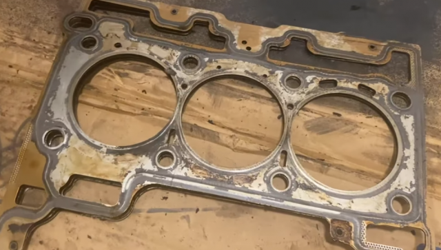

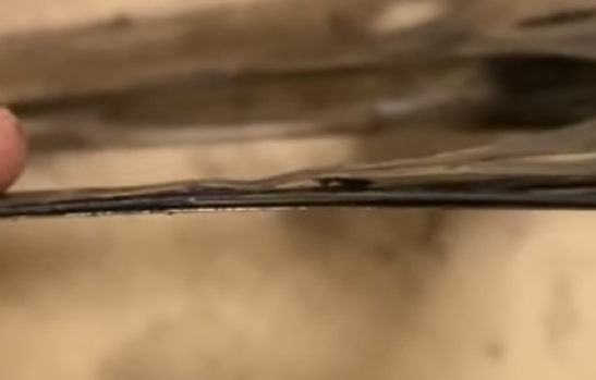

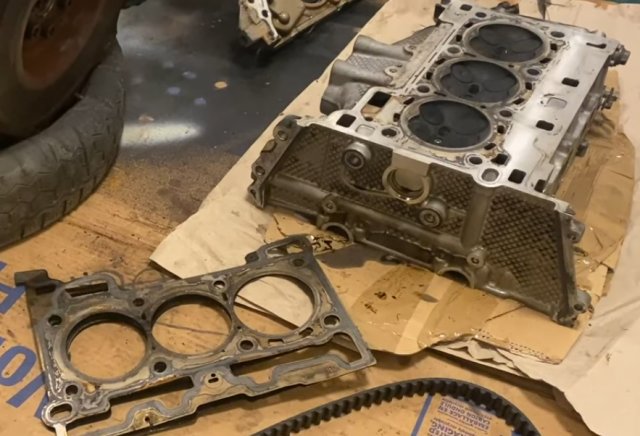

However, as those above screenshots show from a YT vid series from this group Mend It Mod It (they're brits so they are dealing with an MK7 similar model) show what a 3-cylinder 1.0l Turbo is like and how and why its so hard to mend them...
As they found out, the most likely failure of the motor was due to a head gasket failure, so the motor's salvageable but the cylinder head needs machining (warped) amongst other issues, so the effort of making the vehicle move and the owners driving habits - are two main reasons these motors have problems - not from assembly but from the expectations people have in using these things to get to places faster or quicker than they should be used for.
  • In one of the above photos, an edge on view, the head gasket looks to be in two pieces, it's actually a sandwich item. Two plates of metal to mate with the upper and lower surfaces, and the media in the middle keeps the seal and pressures to their sides of operation. So the "edge on view" in the photo plainly shows failure of the media, and so the metal itself was left open to warp under the heat and pressures - causing the fail. This may be the next stage you'll be facing with this motor unless a tear-down and rebuild is done. Which by labor costs alone, puts you into the former condition of having to replace this motor-never an easy choice nor ever a cheap one.
