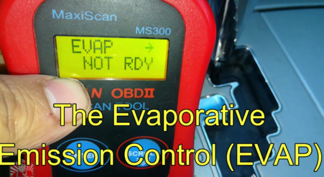

If this condition continues, pay attention to your Check Engine Light...
Also - if you can, buy an OBD-II scanner - simple scan tool - insert into the ODB-II port and let it boot (follow it's instructions) - and look for - in its settings menu....
I/M Monitors >> EVAP System
Check its status - if it says NOT READY - then you know you have issues that relate to the EVAP system and it needs to be checked.
Thats the Fuel system having issues...
