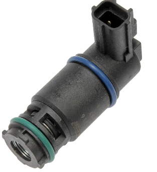

I see that everyone is saying the purge valve is the problem can anyone tell me which one of these 2 part numbers is the right one
1) BM5Z-6A785-C
2) CU5Z-9F945-A
The parts book showing 2 just want to make sure which one
Thx

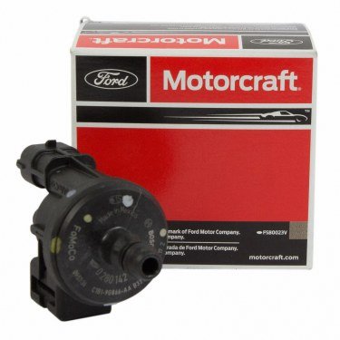

I got a replacement purge valve through Motorcraft parts. They are the same as service parts but are distributed through a different distribution system.
It was number cx2456 and cost around $25 bucks.
I didn't see a service part number on the box. 375x375_products-MCT-CX2456.jpg

2016 fiesta
Thx now I know which one I’m looking for makes it so much easier

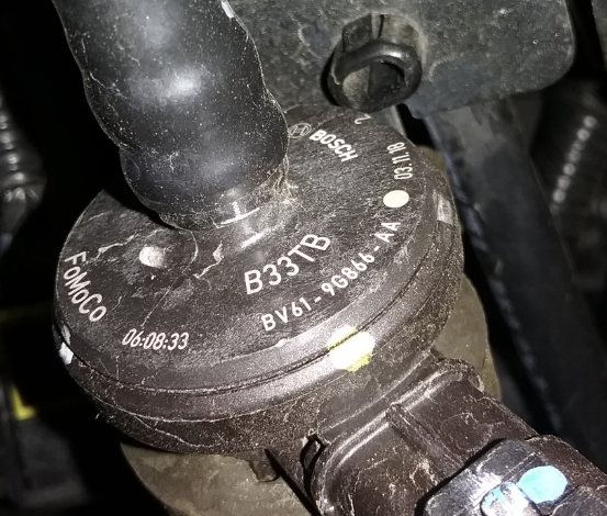

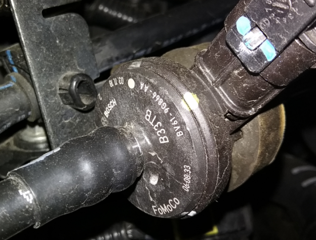

I'll look around my motor to find a number for you shortly..I have SE 2018 1.6 NA type...
Here ya' go!
OR rotated 90 degrees...
As of this valve date 11/3/18 06:08.33
BV61-9G866-AA​

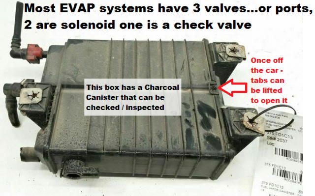

At one point there was a TSB / FSB - on this valve or similar that made a "clacking" sound loudly enough to warrant a recall. So check into that when you have the time to get this to a dealer. (At least one willing to work with you...not that they don't. But if the valve failed OPEN - it can crush the innards of the Canister - but not "kill" the start of the car - it can then leak fuel out of the gas tank onto the floor.)
BM5Z-6A785-C - Vapor Canister Purge Valve
This is the "canister" it's on...
This thing?

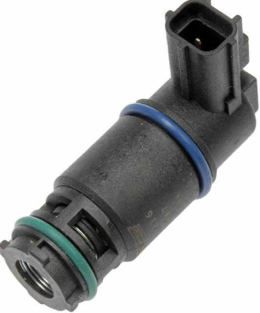

CU5Z-9F945-A
Er...no ...​
1634558096117.png Unless you drive a Ford Fusion or Transit - wrong valve...

Fuels these days have got lot of detergents and surfactant additives that allow the fuel to clean and vaporize far more easily than the fuels made just a decade ago. They also have a lot more Ethane-based (Alcohol - Methyl and Ethyl) stuff to act like a burnable "filler" - their H-O-C chains are a lot shorter than your typical Gas (the Octane Value on the pump) so although it burns - the shorter chains do not provide as much energy as their longer chain Petroleum counterparts.
Kingsford anyone?

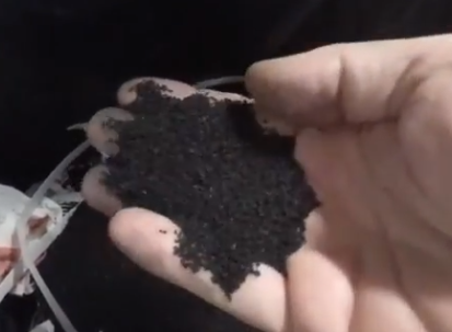

These newer blends? Creates a bit of a condition of "Evap" overload that can prevent the car from starting because Ethyl and Methyl are also excellent solvents - destroying the canister and dissolving the charcoal - putting this mess into the line to be burned at the engine - which if not careful can cause engine damage. It's why you have all those check valves and screens to keep charcoal from getting sucked in, but remember too - there are other problems - air, water and debris trapped in this media - so anything that the valve cant pull - will set a code - but if the canister fails - another type of air leak with no vapors - just air - can form - causing a LEAN condition where you can't start the vehicle because it runs too lean
Now before you can inject (SIC) that the Charcoal doesn't dissolve - er no not directly - but if you use lighter fluid - the charcoal "softens" into a powder - which makes the air getting pulled thru the system to Purge the fumes out of the canister - harder to get thru. If you research EVAP canister innards thru You Tube, you'll see the charcoal lays loose in the canister. So it's not "secured" in a mesh like a catalytic converters core - it's only held back from getting sucked into the motor by a set of screens, or media filters. Got into an accident with careless drivers? Watch out - that is when your cars' back end gets hit, can cause problems with the delicate balance the EVAP system is with the fuels of today - and will give you troubles.

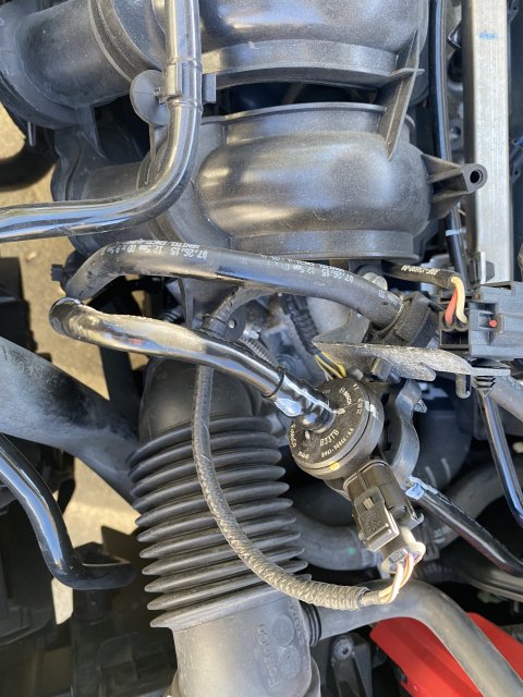

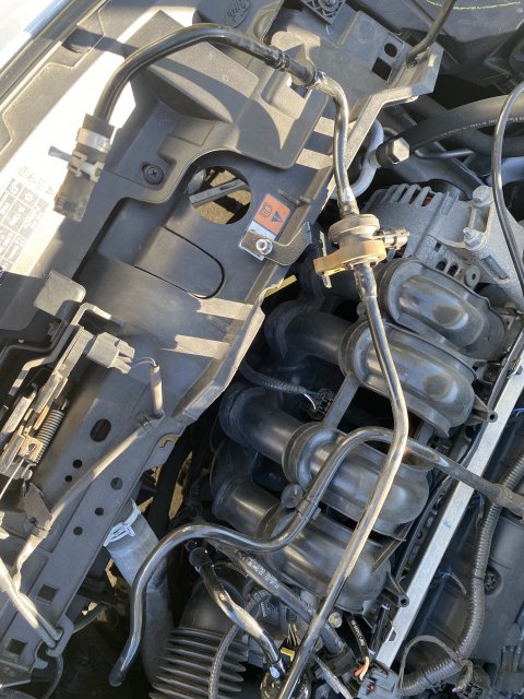

Thanks for all the info this is what I got from Ford it match’s the pics but comes with the lines on it C8866633-4BF5-4B5B-B9F3-32EFEC9AFC39.jpeg C8866633-4BF5-4B5B-B9F3-32EFEC9AFC39.jpeg 260033EF-145A-4047-AA60-9FD38D646943.jpeg and replace it going to see in a few days when I fill up if everything is good

Remember too, to make sure the line to the back is ok too!
Might want to pull some vacuum thru that line that is from that valve - the one that goes to the back and see if it's clear. If it's plugged, then theres more work to be done.
Remember the Charcoal in that canister under the tank - can break down and get sucked into the line - causing a plugging problems further towards the engine or even in the engine itself. (EGR Valve back flow opening - and staying open - will set a code though...) A Fiesta with a Manual Transmission does NOT have an EGR valve - it's a LEV-II class - you'll see it on the sticker under the hood - it will say EGR on it - if it' doesn't then the "hard start" are related to the EVAP and even Throttle Body issues - so there may be more problems you'll have to sort out in this.

Thx for the info I did check the valve and line I removed for fuel and dirt was clear
I’m at a half a tank now will be a few days before I get fuel and see what happens

#13
Ok guys first fill up since I replace the valve and she did not stall and stumble ran great
Thx for all the info
