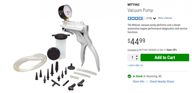

Otherwise you have a vacuum pump in your toolbox?
The one that allows brake bleeding and one man fluid changes?
The tool isn't cheap but it's not too expensive - I have used it to suck out tranny oil and even change brake fluid - so the system is a hand pump and you just need to get a fitting you can take off the valve, and put this in it's place and start pumping to see if you can develop a vacuum.
There is a vial that can hold fluid you "pull thru" in the system so it doesn't damage the pumps diaphragm.
The Pump is also reversible, you can PRESSURIZE the lines to check for leaks, but since this is a fuel line, using gas would be a problem for it can damage the system and the pump let alone being the fire hazard.
That may help, or try to find a simple manifold vacuum gauge and install a tee and simply look for vacuum - if the gauge goes flat and never rises, suspect a leak the typical Evap system generates u[p to 2~4"Hg of pull but not much more than that to prevent the tank from getting crushed.
The only reason I mention the above is not only is it able to detect a plugged line, open line, or you can see if you even have fluid in it - it will get drawn towards the pump - if you can, you can also check the lines going into the manifold, see if they breathe - if they leak, (hear hissing) or are plugged . then you know how to fix it.

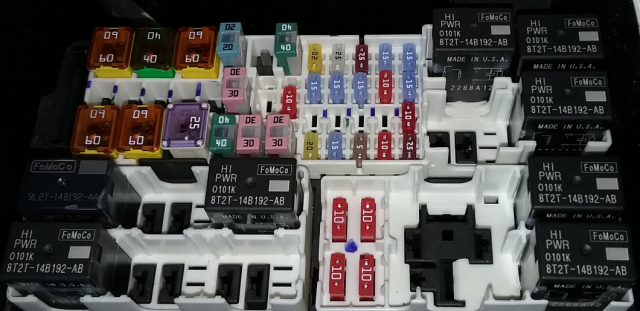

Sorry for digging up this old thread but I am having similar problems. Could you remember the location of the fuse perhaps?
A "missing" 15A fuse?
Well, ANSI/SAE/IEEE places the color code to be "blue" ...
Here's a working Template...
Go find that missing "fuse" - or whatever...
