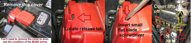

Just to add, the main high current block (that Red Cap that covers the post and the terminals) is in several pieces, any of these can come loose or if loose - then water can seep in and corrode it to a point that although it looks and feels tight - the output connections are broken - have to loosen the bolts and retighten to re-establish or even inspect the connection.

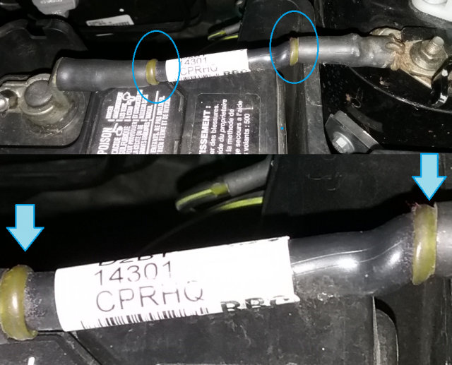

IF this condition is really bad, then you might want to look into stopping by the dealership, or even an Autozone and pick up the Heat Shrink tubing - that comes with a Hot melt adhesive inside it (Might have For Marine Use designation)- so that once you fix the bad connectors - solder them, then add hot melt heat shrink tubing to seal that connection then bolt the eyelet.
If you need an example, you're battery Ground Cable has it - uses it, embedded in it so has temps rise, the "glue" re-melts and seals - but it is not in all your wiring or connectors.
It's also in their High-amperage cable to the Starter and Alternator branch of that terminal BUSS Block.
