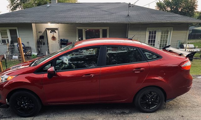

Before anyone says to buy a ST lemme tell you I am broke and I got what I could afford.
After market ECU
So on my Fiesta SE I have after market pars like a cold air intake, after market exhaust, and a spoiler and the whole 9 yards. But I ordered a turbo for but i know the ECU is locked and I was wondering if anyone knew what aftermarket ECU would fit in it. I was thinking putting ST ECU in it, but I'm not sure if it would fit if not I would just buy a new wiring harness.
I was wondering if anyone could help me out because I wanna turbo it but I need a new ECU so if anyone could help me I would appreciate it
