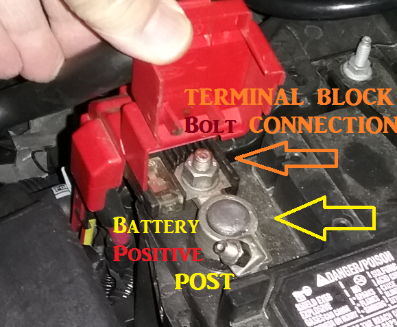

Your Battery has the red terminal block with a cover for the post of the battery and has an "adapter" that uses a bolt to tie it to the wiring harness - a connection - both the vehicles need for electrical power and the way the vehicles recharges power - thru an Alternator use this block - they keep the two separated, so the Alternator has the lowest - least path of resistance for those Electrons to do their job. to get back to the Positive terminal - at that same time - they also feed into the connection going to the vehicle to help power it's needs.

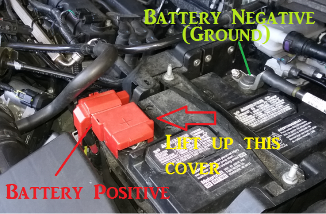

Since you can jump start and everything seems to work, tells me you have a problem with that red post cover - it uses the (EDIT IN:)Terminal BOLT to connect the Terminal block which has the Alternator and Starter cable to the Battery Post (like an adapter) together - bolting both to tie it to the battery post and also to feed power from it to the vehicle - even when the engine is not running - start there and look for loose or even corroded connections at the RED post and also do the same for the Battery Negative post.
It is my fear, something has come loose in the above system

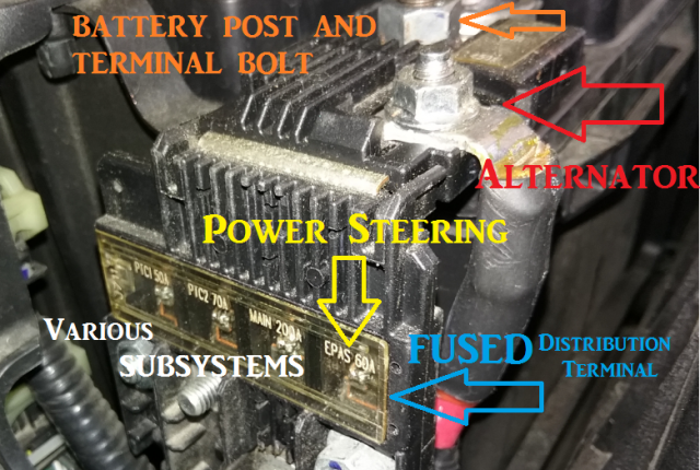

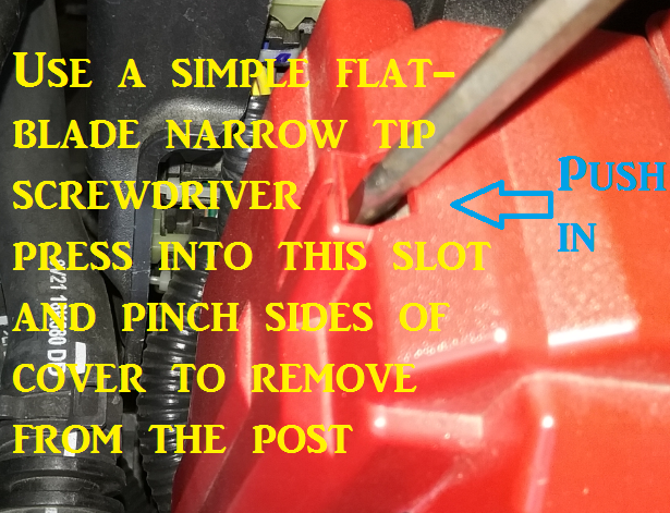

A simple 1/4" ratchet with a couple of deep-well metric sockets like 10mm 11mm 12mm and 13mm really help with this.
Those fuses are fusible links - you can also see where there are several push-in terminal clips and bolts on the terminal block for various systems and like mine - ability to add on an extra wire (or two) for circuits and devices using the lugs on that block for the power access point.
