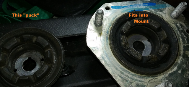

I've had my share of potholes and when you take the struts off - look for the innards to become hockey pucks - simply due to the force of the bump banging them loose out of the housing the shock part of the strut houses in - and it's the larger spring that pretensions the puck back into the housing.
So when you jack up the car things may look normal - remove the upper strut housing - you'll see different.
You'll need a spring compressor and some simple tools and a 13mm "ratcheted" wrench to remove the strut bolts but once all of the strut is off the car - the mount itself may look like it's together - compress the spring the puck might just fall out or off the strut mount to shock stem completely.
So if the puck pops out of the mount - that rattle you hear when you hit bumps is more than likely this event - the puck will no longer seat firmly enough in the housing - that is the rattle and bonk or whack you hear - the top of the puck hitting the underside of the top strut housing - it's loose on the stem.

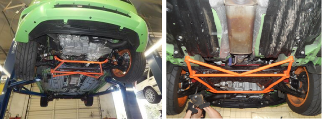

They used to have "racing braces" used by ST owners to keep the body flex down and help with slide and steering in corners - looking at how these are built - it might be worth a try - these are bolt on type of kits but to find them might need a little digging.
About as close as I could find...
2014-2019 Ford Fiesta ST 6 Point Lower Chassis Brace - Pierce Motorsports
The Brace itself use tube steel, but the holes for it are INSET for bolt threads.
You fish thru the dog and carriage bolt and the nut goes on the bottom​

One of my main worries is in looking under the car - the engine is on its transverse mount - but underneath protection does not extend to the front frame or bumper - the "wheel well" is the cutout and main attach point for the motor, axle/suspension steering knuckle while the engine and tranny sit open - in front.
The bumper and front frame or "H" or "U" are raised above and about at the crankshaft height - with all the radiator condenser and other main support "hanging" off that front Bumper and the two rails from the wheel well forward.
In one of the photos of the site, you can see road rash and the need for something under there to help protect that chassis body from rocks and debris - so the ST body kits tend to offer protection but to those like us that have SE S or SES models - you don't get the luxury of that extra protection.
So you're not the only one looking for options.

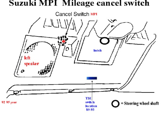

In the olden days, the usual trick was to use an Odometer "lobe" to make a switch that rolled along this lobe from the Odometer force a "Check Engine" or "Service Engine Soon" - you then had another switch in the console that you flipped in a direction to turn off that light - then when the lobe rotated to make that switch work a different direction - you then moved that switch in the console in the other direction to make that switch turn that light back off.
Whether if it was a Sidekick, Samurai or Tracker
You have this little slide switch that you flipped one direction
when that service light came on - you flipped in the opposite direction when
that light came back on again after a given number of miles the Odometer traveled.​
