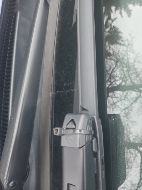

I had to replace the driver side blade on my 2016 ST a couple weeks ago. Aftermarket fitment is a problem. I was able to get a Rain X blade that stayed in place. But, i wouldn't say that it "fits".
The clip that pulls down and snaps into the wiper frame is not very secure. Considering it was over $20 for that one blade, and i had to struggle for fifteen minutes to get it to fitted together tightly enough to feel confident that it wouldn't fly off. For a "name brand" product it's pretty cheesy. I am going to put a zip tie on it before I go through an automatic car wash. 20240208_224809.jpg

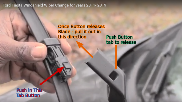

You Tubes' got a plethora of posts about how to change them - they don't give a lot of details in how to Obtain them so you can re-install new ones...

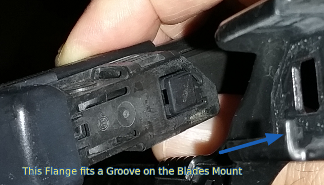

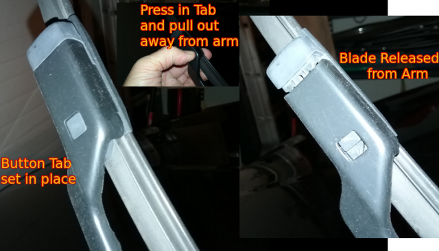

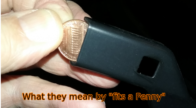

So to help you - you have "Button Release" PBR (Push Button Release - Some call this a Push Tab Button or PTB) design and is 22mm in width (see if it will fit a penny inside the arms hook assembly - if it does that's the 22mm wide width) - that might narrow down the choices to further make it easier - I said easier - not Cheaper.

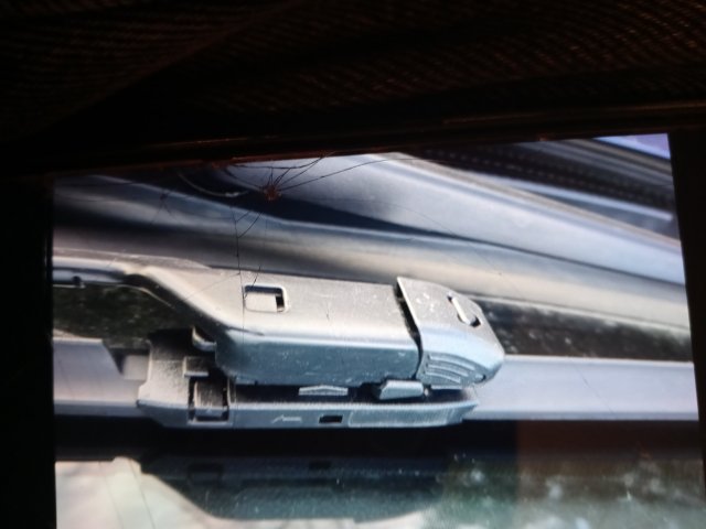

  • You said you have Narrow Tab - So I went and checked mine...
Releasing Blade
Hopefully with the above in mind, you can get to the store and select the correct ones - it is not a "sure thing" when you purchase the Universal fit, for the Universe in that "universal" word, doesn't mean every single arm and mount combo - it means makes of similar fitment for the sizes and lengths - but the mounts that use specific lengths are not universal for all cars - so the adapters they use - you take a guess and your chances - on them.
So Michelin - if they worked before - they should be ok now, but the other brands (ANCO/Trico, Rain X - e&c) may have a better fitment and might cost more but at least you're not scratching up your windshield from the blade twisting and the arm dragging it along trying to wipe when it more like "scrapes" the dirt off your windshield.

I really absolutely despise adaptors. The one that keeps my drivers side, Rain X vision blade "clinging" onto the wiper arm is so cheap that i had to wrap a zip tie around it because its retainer clip barely does it's job.
