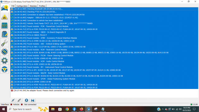

After some research I ordered the OBDLink EX FORScan OBD Adapter and became a member here. I had no problems connecting the adapter to the car and my laptop.
Can anyone suggest where I should start?
Vehicle VIN WRONG VIN 3FADP4BJ6EM106005 ( Donor car) Correct VIN SHOULD BE 3FADP4BJ3EM160524
PCM NONE WRONG VIN 3FADP4BJ6EM106005 ( Donor car)
OBDII NONE WRONG VIN 3FADP4BJ6EM106005 ( Donor car)
APIM NONE WRONG VIN 3FADP4BJ6EM106005 ( Donor car)
ABS , U3002:62-AB WRONG VIN 425061ME3JB4PDAF3 No idea where this VIN came from
RCM NONE WRONG VIN 3FADP4BJ6EM106005 ( Donor car)
PSCM U3002:62-0A CORRECT VIN MATCHES CAR 3FADP4BJ3EM160524
ACM NONE WRONG VIN 3FADP4BJ6EM106005 ( Donor car)
IPC U0257:87-0F WRONG VIN 3FADP4BJ6EM106005 ( Donor car)
BdyCM NONE WRONG VIN 3FADP4BJ6EM106005 ( Donor car)
GPSM NONE WRONG VIN 3FADP4BJ6EM106005 ( Donor car)

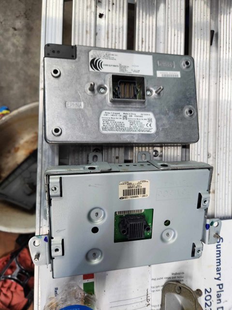

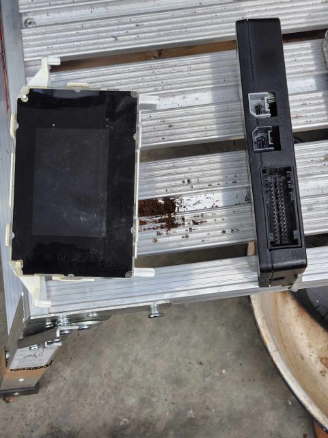

I swapped the Instrument cluster and that gave me the right mileage I swapped the PATS module. I started taking the dash apart and when I pulled the 6" screen out and found the sync modules to be very different..The biggest difference is the sync module is connected to the screen thru a plug. Now what ? (I have a cable ordered to use with FORScan ) 393895544_627703372623725_9026030923128565976_n.jpg
393895544_627703372623725_9026030923128565976_n.jpg 393984090_710511367651121_7739476013106948940_n.jpg 393501301_1069791907286389_2723336967256830476_n.jpg 393632274_699505415556096_571629562353945692_n.jpg 393852304_644050487765210_8445517474711376684_n.jpg
2,051
1,411

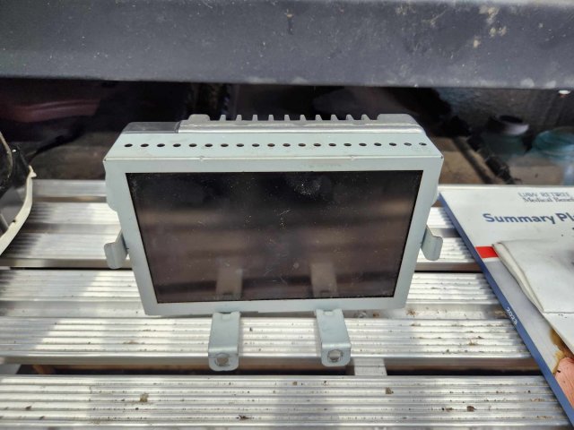

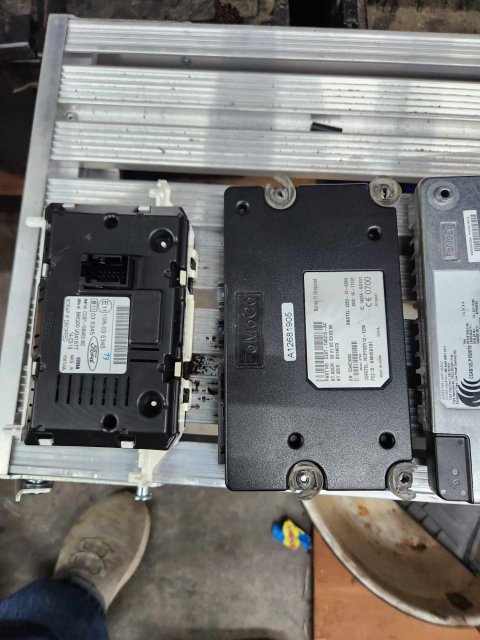

Wow...
The black box SYNC unit, seems to use the SAME connector - only say, on mine the black box is UNDER the Glovebox while this unit, since it's is predecessor - piggys onto the SYNC unit in the FRONT console - so the location is different - but the connector looks to be the same - even to the USB connectors.
So the piggy unit - the one for that older display - is the one you need to keep if you wish to keep the older head and style - else you'll need a new front display.
Part of this problem goes back to what I've told others earlier - when they tried to swap "head units" for their audio system, to a different year - the CHIPSET and it's support are different - your post plainly - and painfully - shows this.
Before you go too far, were you able to get rid of many of the errors when you fixed the PATS system?
Then the older SYNC unit might not need to go - you may be able to keep it and it's OEM wiring. Can't guarantee it.
Had to quick post the above, wanted to add in this - see the connector on the OLDER unit (looks to be from your vehicle) that is where the Audio stereo system "tape monitor loop" goes and shows the frequency and mode display and any RDS music info thru the series data ports in the wiring connector.
So this may sound confusing but did your car have the older single-color (amber?) hex-segment display unit or are you using a LCD hi-res monitor display?
The LCD hi-res display uses a asynchronous type of connection and is why all those pins at the SYNC unit for the CAN bus, but the display module is far simpler hookup as you seem to be finding out - but it needs the NEWER (Black box) Sync unit to handle that data load the system surrendered to, and the rest of the high speed stuff just shuttles back and forth from the PCM and Pods - while the SYNC just "mirrors" that data until you hit MENU.

Sorry to say most of that went over my head. But Both of the units came out of the two 2014 Fiestas I have in my position. Both are stock. If I remember right the difference between them is 5 months.

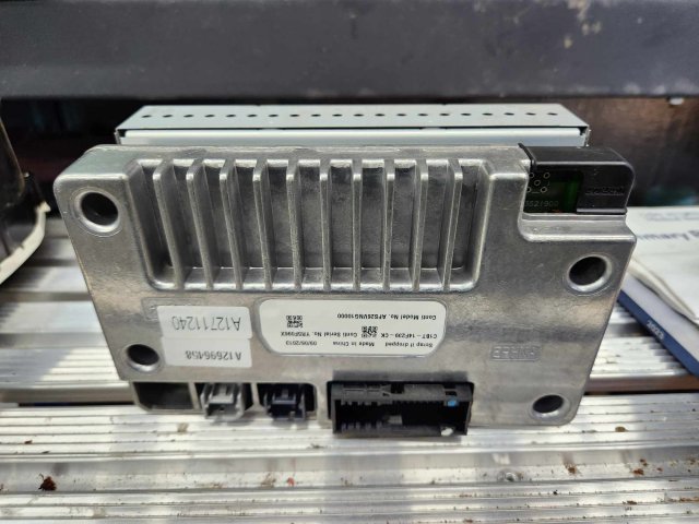

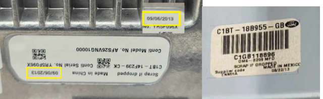

Ok, perhaps this might help...
The OEM car your original one, only has a Audio System - but the SYNC unit - being version 1 is from the other one you got - note the different Ford numbering strings - and the Date Code.
This is what I meant by the "upgrade" - they changed the "nose" and also includes SYNC which upgraded the Audio unit.
You can see that in just the Date code.
So since your car was "mid year" they brought about the changes thru amortization of older stock and it shows by the Ford String Yours - C1BT - 18B955 - GB while the car you're moving into has SYNC and C1BT - 14F239 - CK and a later Date code.
This makes the whole affair a bigger mess due to the dates and chipset changes.
2,051
1,411
#17
Wrong VIN - due to all of them expecting a "Host" to have the same VIN - so now you have "Nothing wrong" except the VIN - you need someone with FORscan or a dealership that can execute a "As Built" where the VIN takes precedence and then initiates a routine that tells the system to "adopt" the orphaned parts.
I see in the list, and I believe it's part of the problem, you do not have your PCM - you're using the Donor.
So you'll have to make a choice - if you accept the Donor - you don't have the manual - it will think it's an Auto.
So you'll need more parts from the original car - so you can set a hierarchy that more parts from your original can reside in the new host. The main ones being PCM and Instrument Cluster
The VIN (again) is a string of digits designed as a unique fingerprint of the vehicle - you're transferring one to the other, but need more of the original so you can override the hosts'.
To help with that here is an attached PDF to guide you in knowing the string that VIN code is.
