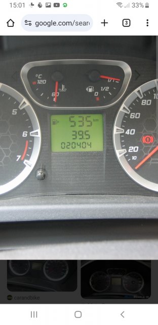

My trip computer shows how many miles in tank and current mpg and total miles like one in photo but in miles
But I can't seem to be able to reset it when I fill up to give me new reading from that moment on
Can anyone help please on procedure to rest Screenshot_20231106-150152_Chrome.jpg
