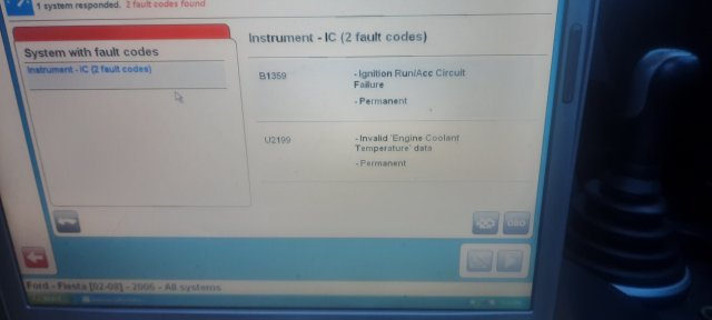

Hi all, i have a 2006 1.4 petrol fiesta. I noticed the engine fan is not working and the coolant is coming out of the expansion tank cap when warm. The temp gauge says 4 bars. If i disconnect the engine temp sensor the fan runs. I fitted a new sensor and the car runs for a couple of seconds and cuts out with the following fault codes. Again if i disconnect temp sensor she starts and runs fine but red temp on dash. Any help gratfully received 20221029_180621.jpg 20221029_172638.jpg
2,012
1,394
Since this is an older car, does the instrument cluster / Pods / HEC unit - has it's wiring been checked?
Since you get "4 bars" - one sender seems to be working - another which is the overheat one that engages a fan, as you found out - seems the wiring is functional to it, but the wiring to the display - thru the instrument panel - might not be all there.
Now what I also see is a "ignition failure" - a wire from the key ignition seems to have failed - was someone trying to hot wire this car - the wiring is not completely fixed. This wire may be the one that causes this fault because of the broken connection.

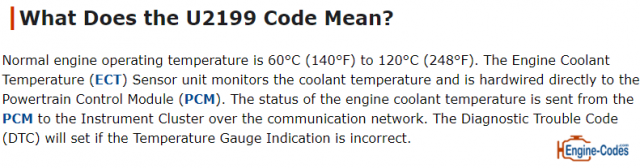

In doing further research, the communication via data network - is what seems to be causing this issue - so the CAN Bus system, the one that works like a USB stick and cables - is down or has lack of connections to relay information to a specific section that the vehicle needs to verify its integrity.
IF it can't communicate to store and compare data - it sets this code.

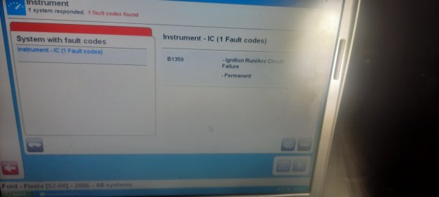

Ok outed the new ebay coolant sensor. Bought one from local motor factors. Everything is now back to the beggining, car starts runs fine no lights on dash, BUT still no radiator fan working and coolant getting to boil out of header tank. Temp gauge does not go over half way any body any suggestions
Ps have read that if thermostat not working correctly the engine can overheat and fan won't kick in
Any thoughts ?

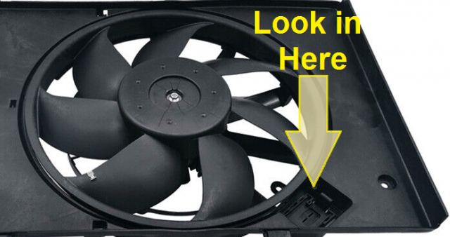

Since yours is the 1.4 Petrol, have to checked the FAN housing? There may be something there...
You may need to verify that the Low-Speed Resistor and its thermostat is in there and functioning - else I'd recommend you try another housing.
