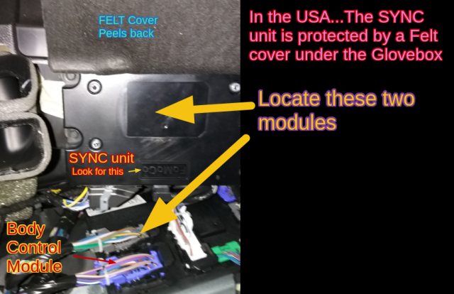

The SYNC module on my 2017 Fiesta SE Hatchback doesn't work. I have tried resetting it to no avail. Typical symptoms I have seen from others with the same problem.
I would like to remove and replace it. However I don't know it's location in my car. If someone could help me with this I would appreciate it. Maybe a picture of it's location.
Thanks in advance.

The later versions of SYNC use a SEPARATE module under the Glove-box and hidden behind the kick-panel felt to protect it from interior scuffing and damages caused by occupants hitting or striking the unit - this also keeps heat off the unit so it fares better in hot weather and due to the climate control system vents by; it can be kept to interior temperatures and by location - provide a better working environment for it.
In this photo, the camera is on the passenger floorboard pointing upwards.
To the left is the center console and the heater blower outlet nozzles - to the Right is the outer kick-panel.
The top black box is your SYNC unit Right under the glovebox
The bottom one in bolted to the firewall; is your vehicles BCM.

Well I did find the module under the glovebox. I took it out. The part number is GE8T-14D212-AD.
I'm having a heck of a time finding a replacement. I have looked seems like everywhere online without any luck.
Anyone here have any ideas. Before I go to the dealer I would like to look around. I have found many similar modules. But not like I have.
