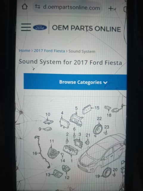

If you go to the Ford oem parts online website and search for "2017 ford fiesta sound system" the diagrams and description of the components will be there. The APiM is a very feature level and build date specific component.

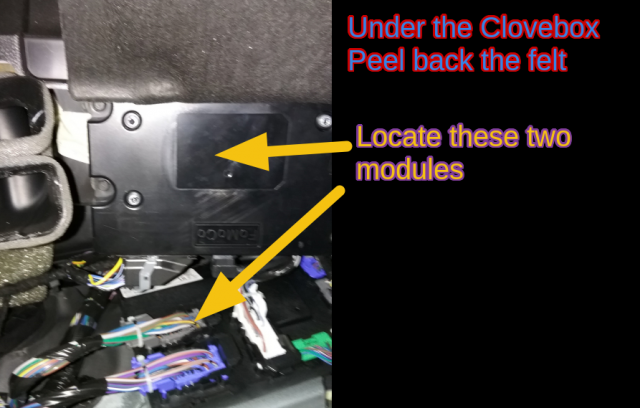

The later versions of SYNC use a SEPARATE module under the Glovebox and hidden behind the kickpanel felt to protect it from interior scuffing and damages caused by occupants hitting or striking the unit - this also keeps heat off the unit so it fares better in hot weather and due to the climate control system vents by; it can be kept to interior temperatures and by location - provide a better working environment for it.
The top black box is your SYNC unit Right under the glovebox
The bottom one in bolted to the firewall; is your vehicles BCM.

Well I did find the module under the glovebox. I took it out. The part number is GE8T-14D212-AD.
I'm having a heck of a time finding a replacement. I have looked seems like everywhere online without any luck.
Anyone here have any ideas. Before I go to the dealer I would like to look around. I have found many similar modules. But not like I have.
