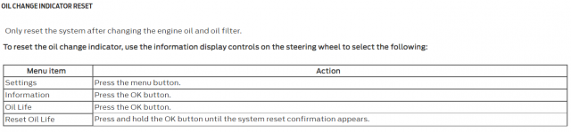

Do you have a "cursory keypad" on the steering Console?
Or You have OK button on the Infotainment system, center console on the Dashboard?
Then;
Start Car,
Turn SYNC on
Call up Menu
Goto Settings
IN Settings Menu locate Information
Under Information locate OIL Life
Then Select Oil Life and press OK to reset this
Might take a moment or two to finish the Reset process, but the Wrench Light should go off.
IF it doesn't then the vehicle has stored a trouble code and the service department will have to investigate.

Thanks Handy Andy , i didn realise what you suggested was a feature on our car however it was so i did as you suggested and Oil shows at 53% so i imagine when we had the issue would have been higher as it was a few weeks ago and around 1000 km less . I did not need to reset anything as the Spanner light is no longer lit , when we had the issue after driving a short while we stopped for a few minutes , when we started the engine again the light had gone and car was running perfectly and has done ever since , no reoccurrence of anything unusual . The light did not come on while i was driving , it came on with all the lights when the ignition key is turned but rather than go out with most of the others it remained illuminated with the Handbrake and a couple of other lights , then remained illuminated when the engine has fired up , just the Spanner and Handbrake remained , that's when i first noticed it .

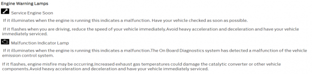

When the "Spanner lite" or in USA the "Wrench Lite" comes on, it serves as a reminder to change the oil. We have a second one that is similar but contains more serious events...
The Dreaded CHECK ENGINE light​
We usually like to see an "Empty" un-lit dashboard, but the Wrench wench comes on it can make people panic and in reaction to it - make them swerve into places to find comfort in knowing that it's really nothing but a reminder.
"While I'm here can I have that to go?"
A quick shake to go and they're on their way...
As far as to why it may have come on...
When a car is first new, the engine "develops" a profile of it's systems - so it sees only specific numbers and values -
As the car "Breaks in" (break in period) the system starts to see changes that it once saw as constants. Sensors are now starting to return various values that are not in range - but are processed - and as the system "learns" - this may set that light as an initial trouble code - that upon subsequent starts and drives later - didn't cause this similar value shift - so the system thinks it's ok and clears that light. It's nothing serious - at the moment (ATM)
So yes you have a right to be concerned - but to panic? No, monitor your driving and if you feel changes in drivability - then take it in and have them review these incidents.
