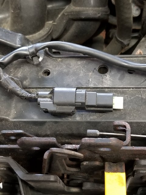

While looking for the AC issue I noticed a broken set of wires coming off the part of the harness that connects to the electric fan. (The reason for this post). This section of the loom has two wires, one green with black stripe, the other is blue with red stripe. These wires go from the wire loom up and are connected with ties to the fan shroud. Ultimately ending at a sensor mounted right behind the hood latch.
Trying to figure out what this sensor is?

It's the ambient temperature sensor. It's part number is AU5Z-12A647-B. if you have already identified broken wires, they should be repaired before continuing. Solder type repair! Not butt type crimp connection!
Many of the components are very resistance sensitive. A shitty repair will often result in either frequent MIL or possibly even damaged control modules or processors. That stuff has very specific power supply requirments.
You should also clean up the ground connections. Many people are having failures due to a poor ground.
