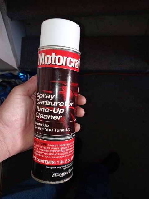

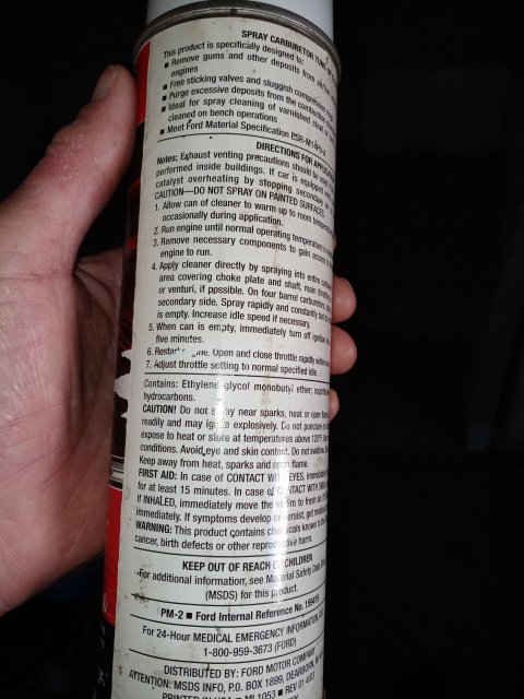

Ford offers this spray cleaner product # PM2 that is not predominantly alcohol. It's rather oily and is great to let it soak inside of the IAC for overnight. If that doesn't fix a clogged up IAC valve, It's done for! 20220629_181448.jpg 20220629_181343.jpg

Ford offers this spray cleaner product # PM2 that is not predominantly alcohol. It's rather oily and is great to let it soak inside of the IAC for overnight. If that doesn't fix a clogged up IAC valve, It's done for! View attachment 6658 View attachment 6659
