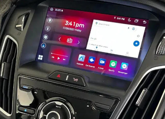

And, to help narrow this down - do you have the HD-unit?
Although from a Ford Focus, These are also available in Aftermarkets for Fiestas' - only seen one with one though...
We also have several Eco-sports in the fleet and they use similar setups...
The HD-units - The radio / APIM display is more like a tablet and about the size of one. IF that is what you have; the HD-unit decoder for the FM-stations - the rear antenna amplifier is still suspect. This is due to the level of sub-channel information that the HD units processes and displays on your cars' tablet-screen. If the system can't decode that information for the stations sub-channels - it flickers data in the display and it can even affect audio. It will - cut in and out leaving you with sometimes terrible sounding fuzzy audio-until the signal strength comes back to a point where it clears up from the noise and you have your "surround sound" audio back.
