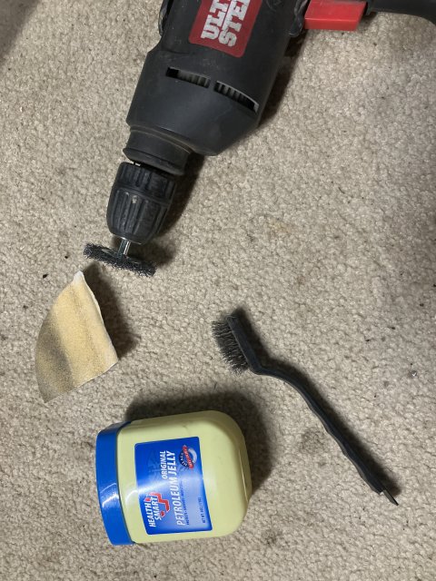

The primary targets for attention are under the battery tray and near the lower side of the transmission bell housing. You will need to remove the battery and tray to get clear access to the upper ground connections. The lower connections are easier to get to by getting the front of the car up on a pair of ramps.
You will need a few basic metric wrenches and a couple of small wire brushes and or sandpaper in 80 to 150 grit. Once you have the connections cleaned up and snugly tightened down, you need to put some petroleum jelly aka Vaseline onto the connections to seal it from moisture and corrosion.
You should also take the opportunity to get the battery load tested to ensure that it is in good condition. Weak batteries are not uncommon and can cause problems with the CanBus network. Just as bad ground connections can also do.
