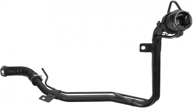

Be sure to look around that Fuel filler and it's neck.
Why? I had to make a visit to the local Ford dealer for a Check Engine light and they simply re-seated the fuel filler neck. Seems that there is a seal on that neck that can move thru time or they, the maker, can move it - during assembly to the vehicle, when it's lifted and assembled. So the movement may make the seals integrity different as age takes it toll and the seal isn't working like it once did, setting the EVAP system code and a trip to the shop to have them look at the reasons for this.
