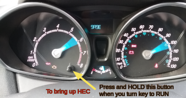

There is also a built in Thermometer that those 4-bars (bar graph) works with - it might give you an idea as to the dynamic rise and fall of the engine coolant temperature as you drive, then stop and idle or slowly move along in traffic.
IF you are aware - there is a HEC test mode.
PDF to do it is attached.
When you're parked, try to do a practice set of runs to engage it and used to and comfortable with it before you start to drive - do this several times so you're comfortable with and can understand the display information.
As you use the HEC, the POD consoles Analog gauges works normally unless it's in the GAUGE setting - so if you just want to see the TEMP or the Throttle or even RPM - you can set this mode by pressing the buttom a given set of times then just drive to see the comparison to LOGIC to the Analog POD display gauges.
You don't have the upper info display like you'd normally see - so the HEC is a rather powerful diagnostic tool but don't let it get in your way of driving - you can use it to help understand the gauges, Fuel - Throttle in a hexadecimal format and changes in status - along with Celsius temperature of the coolant sensor reading.
The HEC can help offset the desire to find another gauge that although is nice to have - forces you into a position of having to install something you may not need the use of later once you're done with the diagnostic of temperature

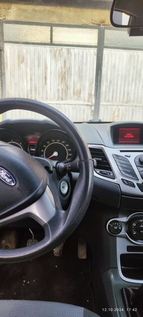

Hello, I will not open a new topic and that I write here. Is there a way to add some engine temperature gauge for Ford Fiesta 11.2010 1.6tdci 90 hp ??? Is there an appliance available for this?? It's weird that I can't see the temperature so I'm looking for a solution, thanks.

Since you've asked, the HEC mode is only possible means to show actual Temperature - not a bar-graph.

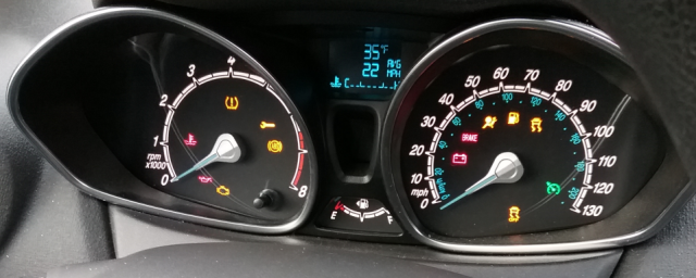

In the above photo - do you own an S model? IF so then the Bargraph is not possible due to the level of the display complexity in the unit - only SE and above will it be "Standard" to see.

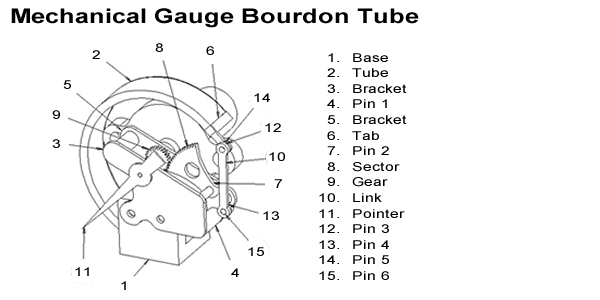

Most of the time, the mechanical types use a Bourdon tube - that converts a pressure of expansion as a force exerted in a bulb and tube into a mechanical movement.
The bulb that contains a fluid that expands at a given rate - that is used to show this - is what limits you in where it can be installed.

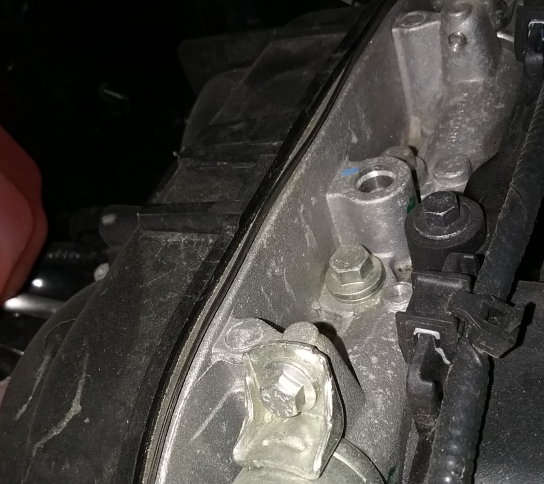

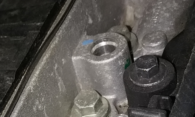

You can locate the Alternator and it's bracket there is a "hole" just above it in about 8mm size - that is open on the Cylinder head. But to fit something like a tube in there might be difficult.
The top of the engine between the Valve cover - front timing belt cover and right between the Valve timing solenoids.​
Each temperature gauge system that uses Mechanical has it's own bourdon chamber tube, the fluid it uses to expand and contract by, and the capillary tube used to send this pressure to the gauge to register it as temperature or what it is calibrated for.

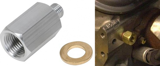

A good example would be Speedway Motors on Amazon, they provide adapters to help you fit a mechanical bourdon tube unit to basically bolt onto a hole but that hole size looks for 12mm X 1.5 pitch - but the standoff result is about 2 inches off the motor - so it's going to have to wait for that adapter to transfer the blocks heat thru it into that sender tube - so it may not be as accurate as you want it to be - so you may need to make some hard choices.
If you're looking for accurate - the physical/mechanical are the way to go, but they don't interface well with the newer smaller blocks and their clearance issues, on top of the fact that 12mm holes on the block are used mostly for the motor mounts and are well away from any sort of sources you can use to get any worthwhile readings.
