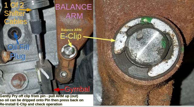

There is a pivot point on the main transmission under that box cover you used to change the (Or Fill Transmission) oil at.
The cover is supposed to protect the area from getting debris and dirt so the pivots and their gymbals can move freely.
When it rains, and there's deep water or very high temperatures, water entry is possible - the gymbals nylon guides can deform - affecting your ability to find the right gear. With the water, rust can form on a main pivot point the shifter uses like a balance arm - to help apply forces from your arm shifting - to the gears and help reduce fatigue when driving in stop-start traffic - keeping it from getting tedious - to a point.
That pivot looks like a E-clip on a shaft that contains that balance arm. It pivots those two cables onto a shaft that translates the motions of those two cables - your input - to a shaft - which slides and rotates to convert your shift pattern into effort the gears that are part of that H-pattern, use to engage and dis-engage from their positions to shift your vehicles gears on the gearbox shafts.
Might want to take that cover off and expose the main shifter-translation assembly so you can look for that E-clip - remove it. Pry the balance arm away - towards you - so you can place a few drops of oil in the hole of that arm to flow lubricant on that pin - then press the balancer arm back into position and re-attach the E-clip. Check shifter operation - if it still binds up - then there is a more serious problem internally and may need more inspection - so be sure to check and refill your oil level in the gearbox - for if it's leaking this hard shifting can lead you down an expensive rabbit hole you don't want to go down.
