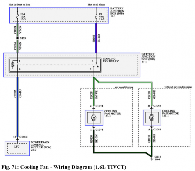

IF the relays are fine - then it's possible, a long shot, but possible the "override" switch in the sensor burned up from the trigger to set off the relay - which can burn out i time because it forces the Fan relay on - it does have current thru it - the wire is small gauge designed for intermittent use, not all the time - else it too, can blow open - it depends on if you have single wire or dual wire or triple wire - even four wire (with temp sensor included)
Be careful with this.
There are several "Variants" of the Cooling Fan.
If you have a 1.0L Ecoboost motor - 3-cylinder - it uses a Fan/Resistor/Relay-to-Resistor(LO)/Relay-to-Fan-bypass(HI) speed system - so you have TWO relays in the engine compartment. It also has Shutter and cooling pump in the engine bay.
IF you have the SE with the 1.6L TiVCT you have 1 relay and the PCM controls the relay no variable speed...

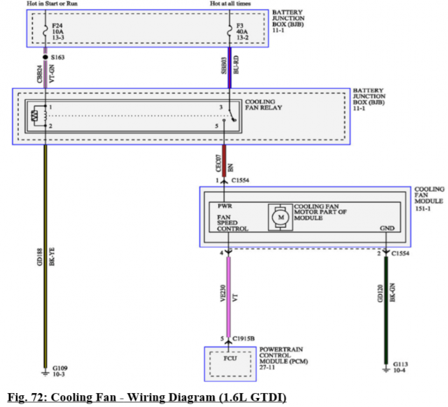

If you have the GTDI (Direct Inject no fuel rail just line to top of motor with a big thingy on the side of the motor that pumps the fuel in there) it has injectors in the cylinder head directly inside the chambers spraying fuel. It uses a MODULE on the Radiator shroud housing that determines the temp at the radiator - and the PCM controls it directly.
You'll have to choose your poison...
