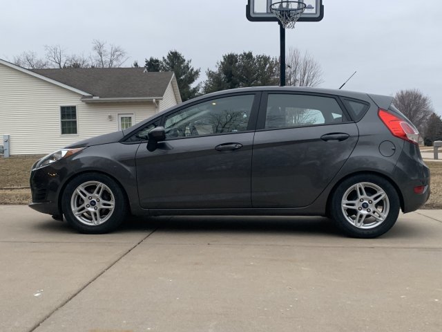

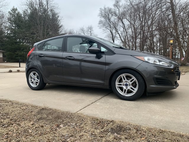

There’s also the H&R #51641 set. It’s a mild kit that won’t brake the bank or your spine.
