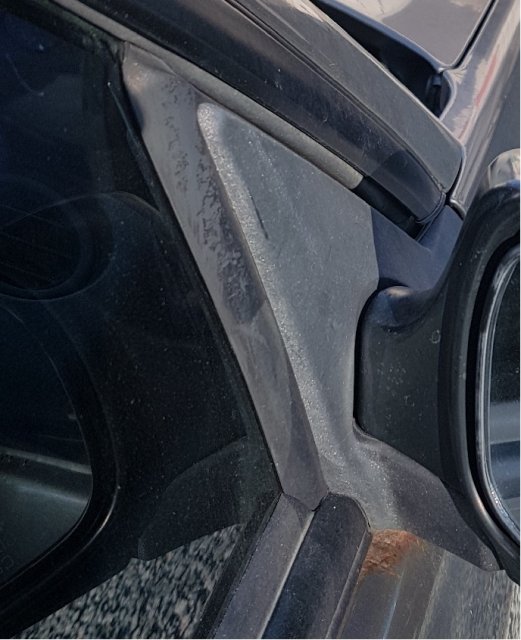

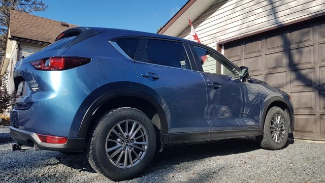

Oxidization or fading of the textured black trim and accents is one area that can make or break your car's look. Even clean paint will wain visually next to old neglected trim. Due to its composition and texture, plastic trim needs special care to maintain its visual appeal as well as its pliability.
Plastics naturally don't deal well with UV rays from the sun and require inhibitors during manufacturing to help maintain colour. With age plastics will dry out and become brittle and more susceptible to damage. The texture of automotive trim plastics also tend to easily buildup a layer of fine dirt and grime.
Regular cleaning and treating textured trim will keep your accents clean and visually striking against your nicely washed and waxed paint.
I will warn using trim products generally leads to continuing with a regular regiment of care. I have never found a trim product that will properly restore and maintain in one application. Periodically you will have to reapply to maintain a nice clean shine. As time passes, the effort required to maintain will lessen when your trim is properly cared for.

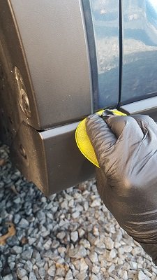

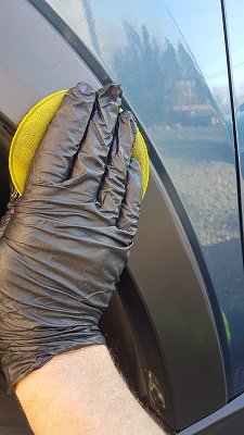

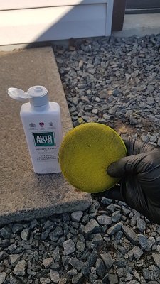

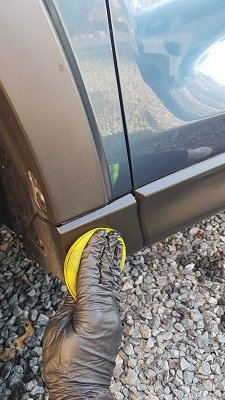

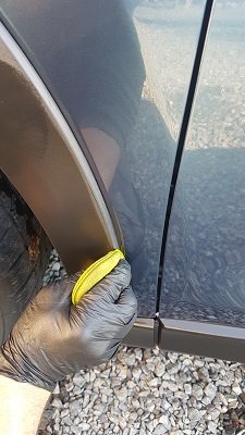

Prime the pad by dispensing some product and working it into the foam. Choose a location to start and work around the car applying a liberal, but consistent amount of the trim product. As you apply, work the product back and forth to reach deep into the texture of the plastic. Add more product to the pad as required and work along the trim.
Using the foam pad flat, you can apply to a flat or large surface. Apply so as to not get any on the paint. Should that happen, most products can be buffed off with a clean microfiber to remove streaks.

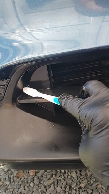

By pinching with your finger tips, you can use the edge of the foam to work along edges cleanly. Work product into crevasses and corners using a small amount of gel applied to a toothbrush.

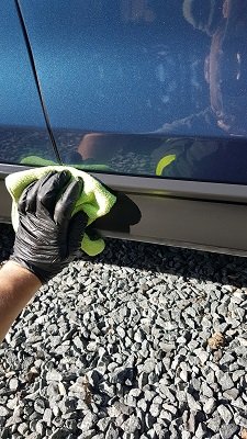

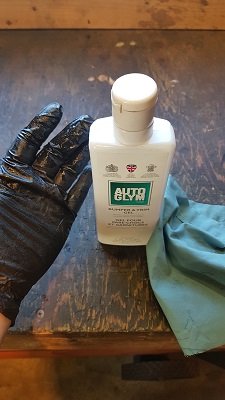

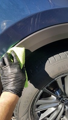

Once you have completed applying to the whole vehicle, grab a microfiber towel dedicated to silicone use. Gently buff and rub the plastics to bring out the clean like new look. As an added bonus, repeated care will prolong the look and protect the trim.

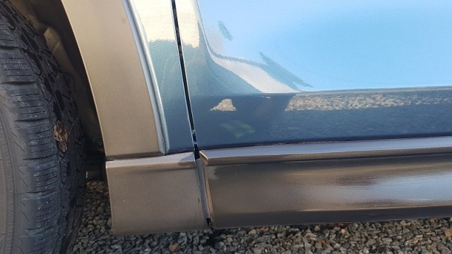

I only periodically apply trim dressings. An application can last through a few washes and its lifespan is dependent to how much and were you drive your car.
After completing the job, you can sit back and admire how the clean trim accents your paint.
A little bit about the products...I originally started out with the Mothers Back to Black with decent results. Although the trim on my MS6 wasn't in poor condition, it worked well to bring back darkness and shine to the plastics. I have since changed to the Autoglym line, it seemed to last through more washes and rainy weather. The Autoglym recipe has also changed in the time i have used it. Originally it was olive green and thick having more of a grease consistency. The company has since changed it to a clear liquid formula. I find the new product easier to spread consistently, but also easy to get everywhere...reminiscent of the anti-seize dilemma.
