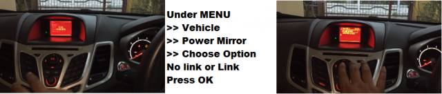

My experience with the Euro version of the car is probably a bad relay which can be found under the headlight. If you are from the UK, then it will be the offside headlight. There are a couple of relays there so you need to refer to the owner's manual (in my opinion the manual does not seem to have this written down). If not information is found, just buy a good relay and keep testing to change either one of the relays. Good luck!
