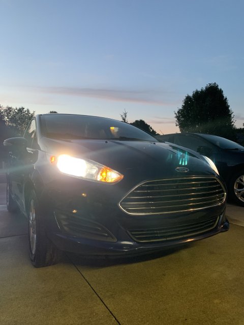

Hello! I would just like to introduce my 2016 Ford Fiesta, Paquito. He’s a 4 cylinder 1.6L engine and very useful in everyday driving. I don’t know a whole lot about cars yet or even about forums but I’d like to document the changes to my Fiesta as I get around to them! Right now nothing has been added on or modified but some of my future hopes are to replace the missing left rear reflector, swap out the halogens for some brighter ones, do some interior vinyl wrap accents, mudflaps, and possibly even some bigger modifications such as a nice exhaust kit, and the list goes on! If anyone has any cool ideas or suggestions let me know because I have a blank slate and am open to anything! AC8F3C4D-9B61-4982-B476-5CA857975F22.jpeg

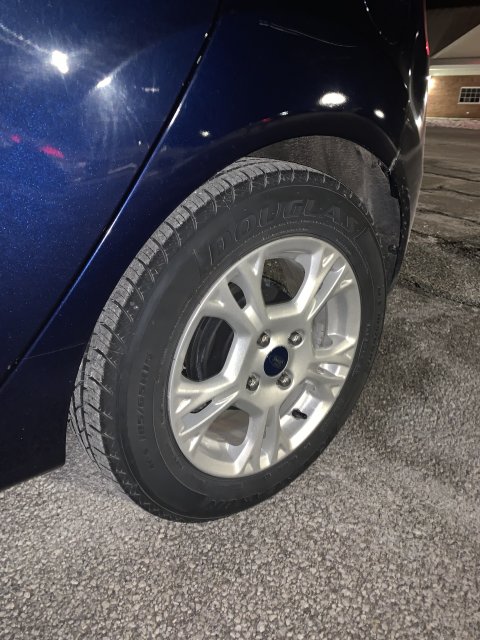

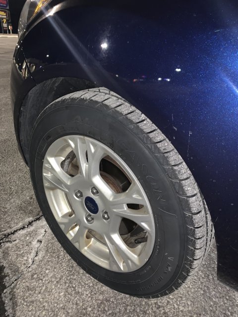

Lil update on Paquito: I got new tires put on after he was starting to wobble when driving and the steering wheel would shake. No more wobbles or shaking and rides very smooth now. I also have electric blue carbon fiber vinyl for the interior trim and hot pink LED’s for the dome lights on the way; so more updates will be coming when I get around to doing those little projects :]

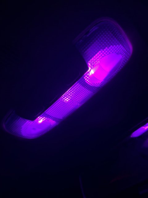

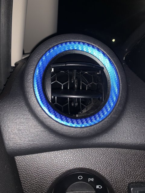

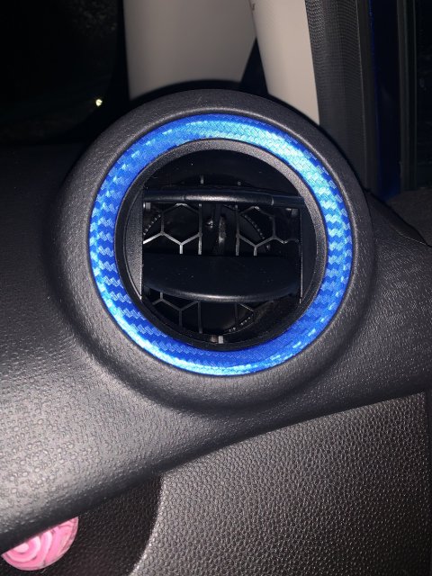

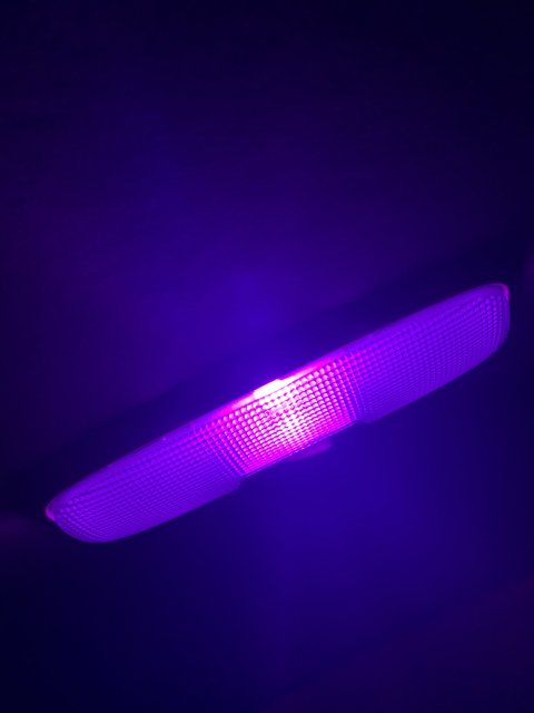

Just updating the recent progress on Paquito: Started wrapping the interior trim of the car, starting with the air vents (actually I can thank my boyfriend for those) but the steering wheel trim and center console trim will be wrapped in the same blue carbon fiber vinyl very soon! I also switched the map lights and dome lights to some hot pink LEDs. It really is the little things that matter and I absolutely love the changes so far!
LEDs: Partsam 5X Pink-Purple 5-5050-SMD... https://www.amazon.com/dp/B00XY4MB2E?ref=ppx_pop_mob_ap_share
Vinyl Wrap: VViViD XPO Electric Blue 3D... https://www.amazon.com/dp/B00FXYBBAG?ref=ppx_pop_mob_ap_share

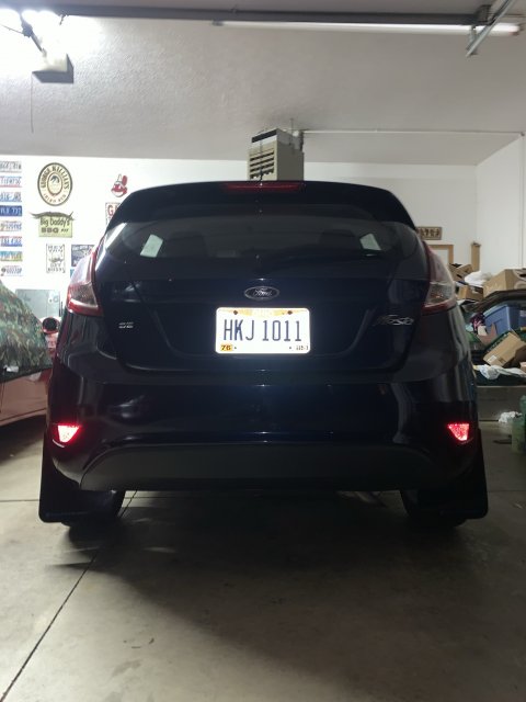

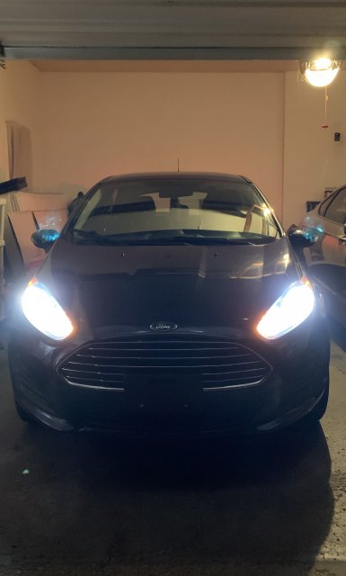

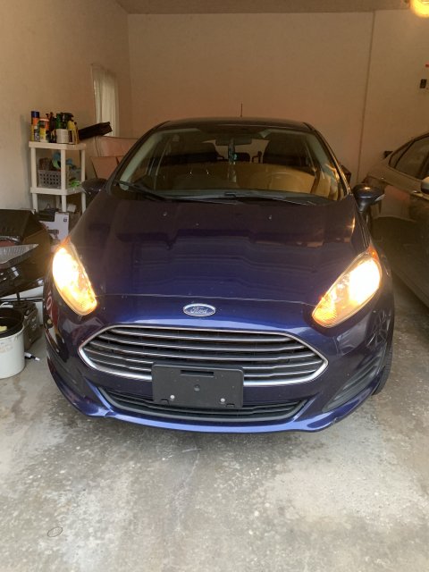

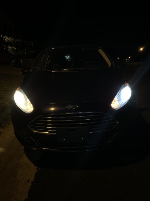

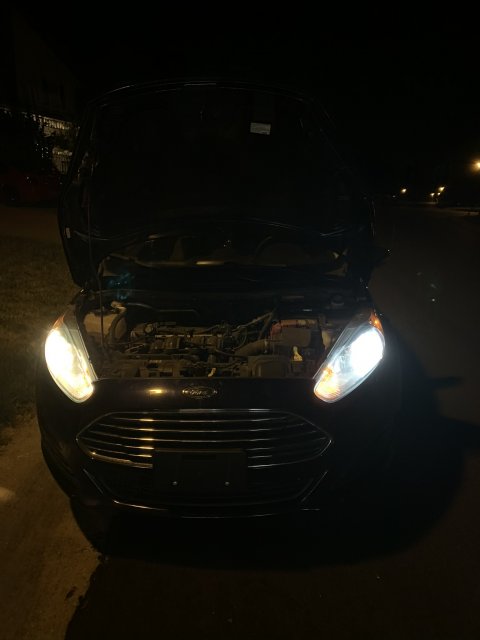

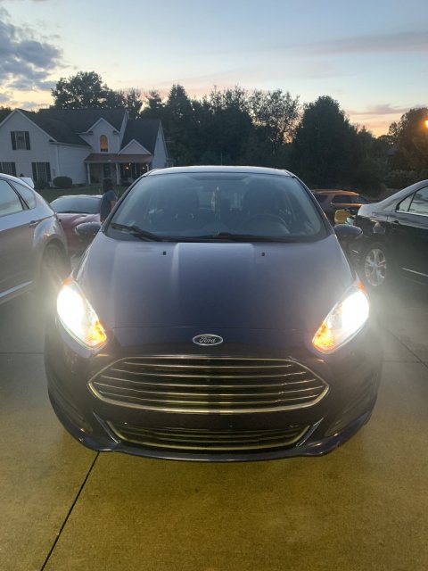

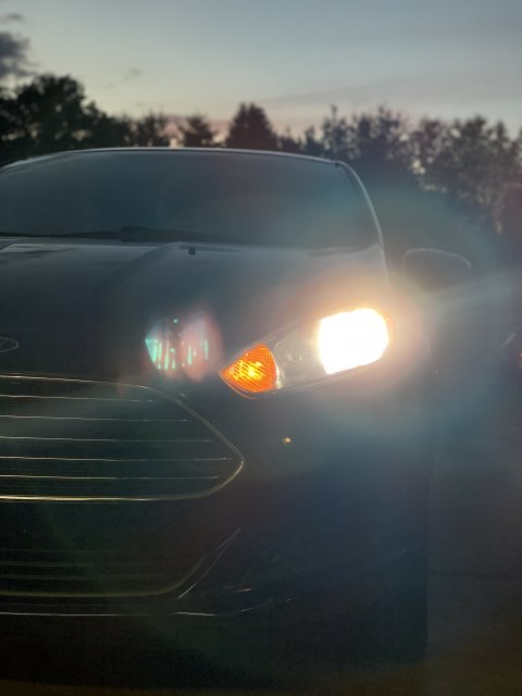

Long time no see! Since I’ve been gone from the forum, I’ve replaced the missing left rear bumper reflector and I also swapped out my headlight bulbs for some Philips Diamond Vision H11s. The headlights have been in for 4 or 5 days and have been working wonderfully. For $26, they’re definitely not LEDs but a very close alternative! The pictures show the difference in bulbs as well as both bulbs installed.
Link to headlights if interested :] PHILIPS - Diamond Vision H11... https://www.amazon.com/dp/B00GD8OL62?ref=ppx_pop_mob_ap_share

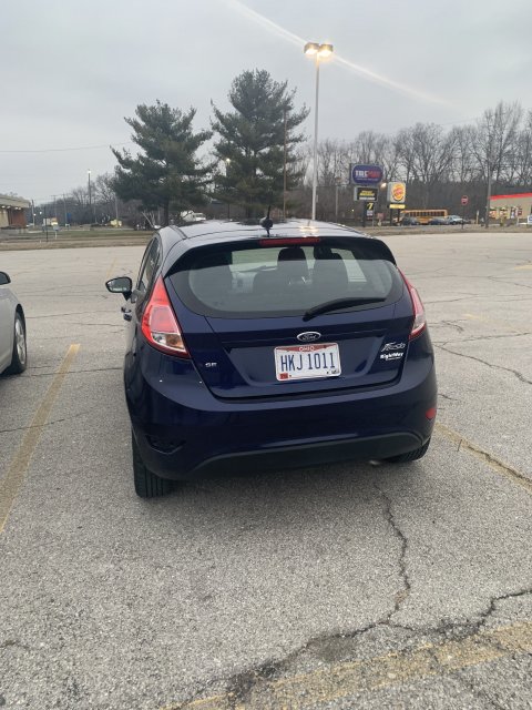

Back again! This time, I present Paquito with a front license plate bracket delete. We drilled out the two bolts in the bracket starting with a 9/64 bit and working our way up one bit at a time. Eventually the bolts were loose enough to force out with a flathead screw driver. To cover the holes I ordered some color matched bumper plugs from https://bumperplugs.com/ They were a little pricy for two small plugs but definitely worth the money. Highly recommend and it took maybe 15 minutes max! See the before and after in the pics below :]

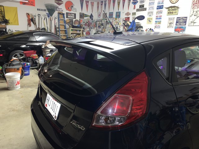

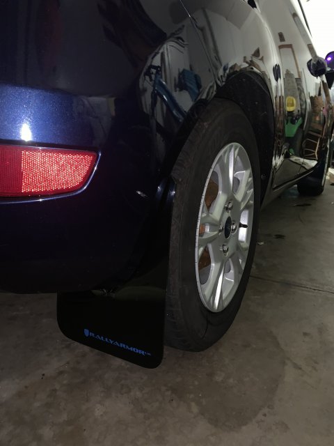

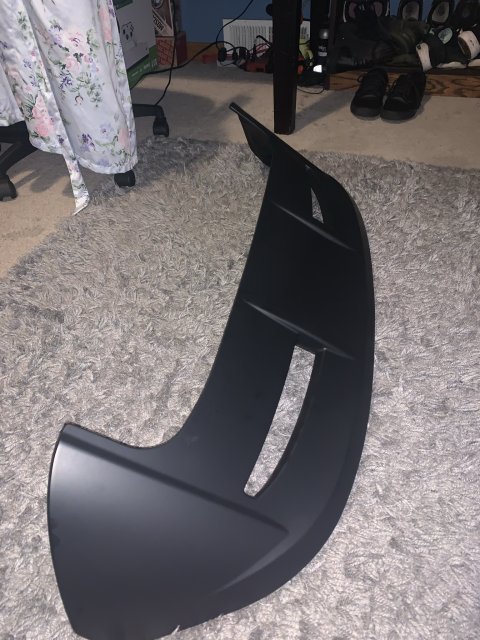

Long time no see! During this quarantine I’ve managed to complete a few new projects. I purchased and installed some Rally Armor mudflaps as well as installed an ST style wing. A little more detail on the projects:
-Mudflaps:
The front mounts and flaps installed perfectly fine with a direct fit. The back ones required a little finessing as the flaps are meant for the ST which has an extra bumper piece for the middle two mounting points. To fix this, I drilled a small hole through the bumper and ran a good old zip tie through the middle hole of the mudflaps on both sides and they seem to be holding pretty secure so far.
-ST style rear spoiler
This was a pretty easy job.... until one of the bolts in the stock spoiler was stuck to the nut and refused to loosen. With some help from my boyfriend, a ratchet for the bolt and some pliers to hold the nut in place, we were able to get it off and the new spoiler was able to be easily installed. The spoiler I bought even came with an extension for the rear windshield washer fluid sprayer. Also, the stock wiring for the third brake light was the perfect length to fit through the new spoiler. The spoiler is currently a primed grayish/black color so I would like to paint it a gloss black to really seal the deal.
