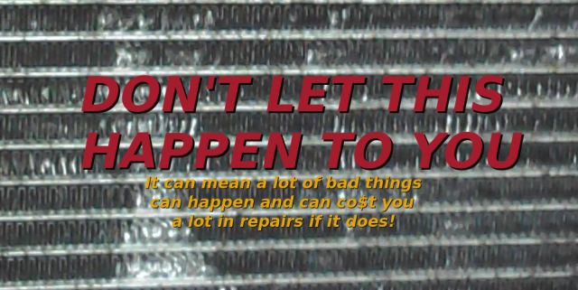

And any impacts to the Consensor will affect the AC - so you'll need to rinse and inspect the front inner grille section on a regular basis with water to flush and rise off any debris and chemicals that are used for de-icing and dust-mitigation along with rock - bug impacts which can perforate the fins and cause leaks.

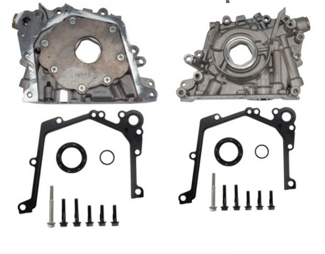

Oil pump - driven by crank gear (or lobe) for the 1.6L GDTI or TiVCT and crank driven gearing vacuums or sumps (pulls) oil out of the oil pan and then by the gearing - squeezes it into it's outlet to the oil filter

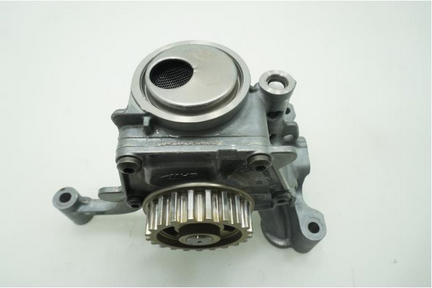

- if you have the 1.0L Turbo'd 3-cylinder - that is using what we call a wet-belt drive gear set to pump oil...the belt is driven by the crank using a tensioner assembly, that is buried, submerged into the oil

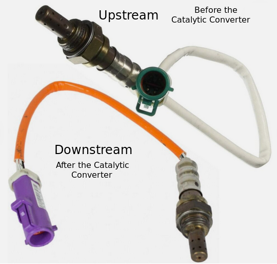

Oxygen sensors? Unless they've been struck by road debris or start lighting up the dashboard with the Check Engine Light
and cause issues with driving - like hesitation and or cause rough idle and make the fuel mileage drop to the floor, do not need any service. However if you have driving performance and power delivery issues - then you might want to have the system inspected and even switch brands of fuels due to the poorer grades or dirty fuels some stations will try to push on you - some have the older detergent additives that when combined with other blends of fuel - can even form a toxic goo that will plug up injectors and even damage the catalytic converter.

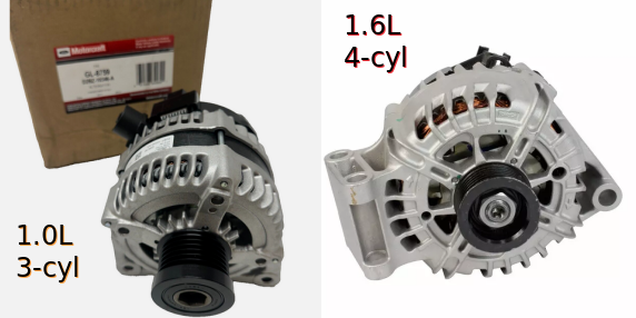

It's your serpentine belt that may need more maintenance as these systems combine their wear onto the belt for you did not mention the conditions of the Alternator or AC Compressor which are two of the major loads placed on the motor for everyday driving - and if their pulleys don't align onto the belts line of travel or don't turn freely - will destroy the serpentine belt and leave you stranded soon enough.
