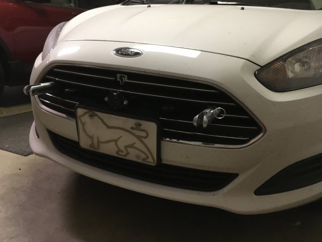

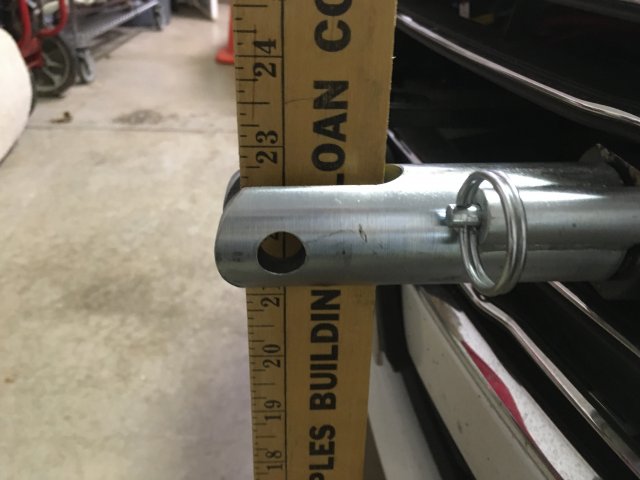

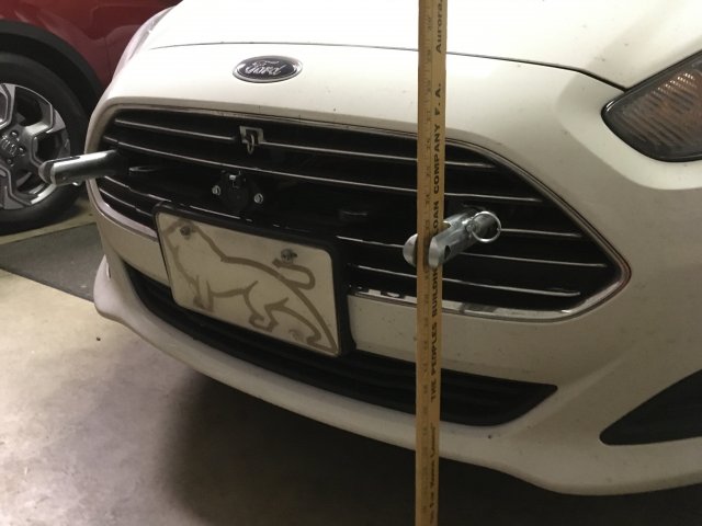

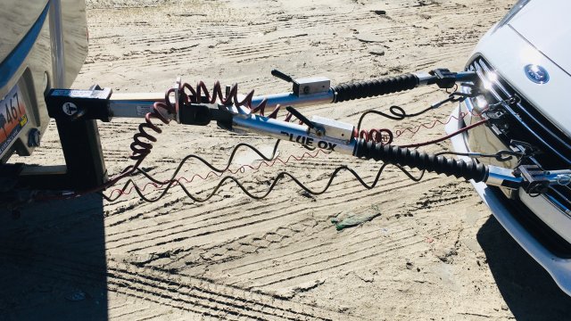

It mounts so high. How is the steering connected? It looks like it's attached to the bumper beam. The steering linkage must be attached either at the knuckle or the tie rod ends.

First, your statement " It mounts so high". What FACT do you base that on?. The hitch attachment height is within manufactures spec. The base plate attaches to the frame at the bumper beam height. Steering linkage? There is NO steering linkage attachment as the car follows the coach. I've towed this rig nearly 6000 miles without a single problem.,. Your statement "The steering linkage must be attached either at the knuckle or the tie rod ends" confirms your complete lack of knowledge of which you speak.. I strongly suggest you download installation instructions form BlueOX or Roadmaster,

I just found this thread - and, yes, I tow a 2018 automatic Fiesta SE all wheels down. There are several steps that must be taken to set the transmission into neutral, and as a result, the key must remain - so I have a disconnect on the negative battery terminal. By the way, I have the Blue Ox Base plate and the connection points are higher that what your loadmaster is showing. I'm getting set for a trip and will post photos soon. Happy to answer any questions as this is my 4th motor coach and 3rd 'toad'.

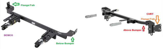

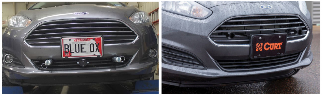

But I've got questions! (???)
It's with the heights...​
So the Blue Ox uses Tow to Draw "rise" was about 15~18 inches up using the lower grille, while Curt it's closer to 22 inches, .using the upper grille.
Now I did see there are tabs and or flanges these kits come together with and formed for - but I am curious to know which is best for my needs...
You Chose Blue Ox, but they have below-the-bumper, What choice did you make - or did you have to settle for - to make this work?.

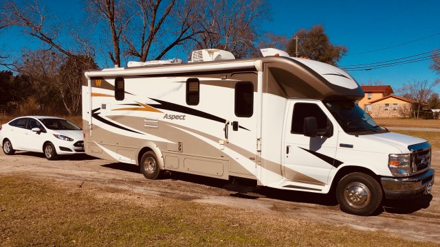

Because the receiver on my Winnebago Aspect 28T was lower than the base plate attachment points on the Fiesta, I had to have a drop receiver (inverted) to give me a safe connection. Safe means that the tow bar attachment on the car needs to be no more than 4" lower than the connection at the RV. My receiver on the RV was 15" above the ground. I added a 10" lift, making the connection on the RV at 25". The connecting points on the Fiesta are at 22", which is 3" lower and within spec for safety. I already owned the 10" drop receiver or I would have used an 8" one. At some point, I may exchange for an 8". Aspect-Fiesta.jpeg towbar connection.jpeg

Because the receiver on my Winnebago Aspect 28T was lower than the base plate attachment points on the Fiesta, I had to have a drop receiver (inverted) to give me a safe connection. Safe means that the tow bar attachment on the car needs to be no more than 4" lower than the connection at the RV. My receiver on the RV was 15" above the ground. I added a 10" lift, making the connection on the RV at 25". The connecting points on the Fiesta are at 22", which is 3" lower and within spec for safety. I already owned the 10" drop receiver or I would have used an 8" one. At some point, I may exchange for an 8". View attachment 4486 View attachment 4487
Thank you for the detailed information about the tow bar hookup! As a seasoned veteran of flat towing, your Input on the subject is greatly appreciated. Most of us here are not experienced with the unique situation and equipment of flat towing.
