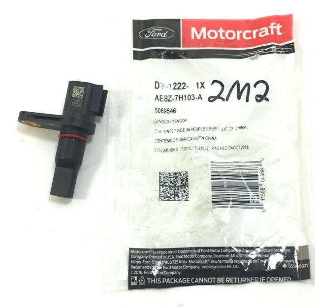

There is also this...
This is the OUTPUT shaft speed sensor for Automatics.
So if you did fronts - there are several places something could have gone awry
