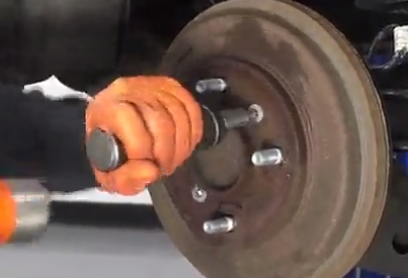

The above is a clip off a vid showing they use a Impact driver and Torx 40 bit to smack the heads to ring them loose.
Now, once off, do you need them back on? To me it's a personal choice.
But on my 2018 Fiesta, I didn't have the issue - and have left them off so I can pull the drum and tip it over to remove the brake dust and inspect the system on a regular basis when I need to rotate the tires at or around every oil change as time permits.

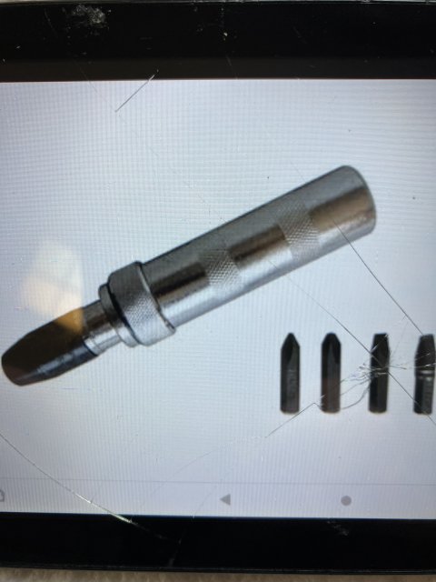

Never seen a manual impact driver before. I tried a makita one but it didn’t budge.

I like the combination of heat and an impact driver set motivated by a 4 pound hammer.
Then apply some anti seize compound to the thread and pan of the retaining bolts when reassembling it.

Well I’m pleased to say that the impact driver worked a treat! Yay. Many thanks all. Unfortunately the rear drums are very badly pitted and must be replaced :( next job.
1,902
Great! And if you never have need of it again for it’s original purpose, it will make an outstanding self defense weapon or a lethal blunt force instrument if secured to some rope!
Otherwise, it’s just a nice tool for breaking seized fasteners free.
