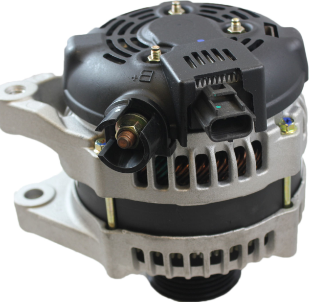

Other signs are loose or worn bearings in the alternator causing charging issues from belt slippage from seized bearings or belt slip - or even corroded terminals from seals breaking down due to age and heat. Might need to have your charging system inspected or even tested. Alternators can set you back about $150 + USD even rebuilt aren't cheap.
