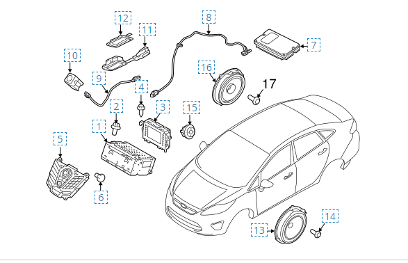

IT requires taking the dashboard apart, starting with the top trim above the backup camera APIM unit.
Then once the radio is exposed and open - you can examine the harness and the APIM unit.

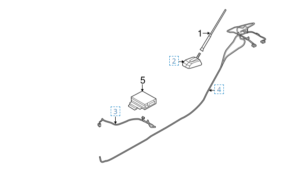

The connectors may have come loose, or even the AM/FM Radio antenna may have gotten water in it and has now failed - the antenna has an amp in it powered by the radio.
Radio side
Now the Antenna...
So, you know, many of these cables are now discontinued.
So, you'll have to take it apart, examine and assess then decide if it's worth pursuing the fix - else like many of our drivers - they just take along a Bluetooth speaker and run the "radio" thru it and the chargers 12V adapter to charge it and the phones APP playing the station as a streaming device.
