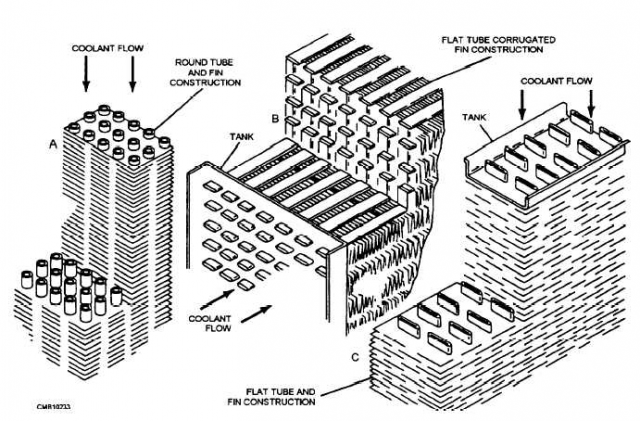

As days in the summer are hot and humid - the car engine does not need a "long time" to warm up - so to wait and let it do so, it just wastes gas. So the OEM thermostat would keep the engine pretty hot in the summer - usually the OEM for a typical small-block chevy carbureted car was about 185~190 degrees F - it also had modified radiator systems - which provided more cooling for motors that used Air Conditioning. They called the radiator capacity as by a figure of cores, usually the typical non-AC vehicle used 2-core radiator, while others with AC installed used 3-core.
What are cores when it comes to Radiator?
It's the number of rows of cooling tubes that spanned across the width of the radiator.
The more "cores" you had, made a "thicker" radiator
- making it capable of taking away more heat from the motor
to help keep the motor cooler in a wider range of hotter operating temperatures.​
The typical Fiesta uses a 2-core radiator and it's mounted BEHIND the AC condenser unit - which helps the engine "capture" heat when it colder outside - the Defrost setting runs the AC compressor and so the heat exchange function applies here. In cold weather - just like it does in the hot summer when you have the AC on. It takes heat out of the air (Evaporator inside the car) and concentrates the heat differences in the condenser and lets the cool air "cool" the condenser and in doing this, carries the heat away into the air flow and this heated air flows thru the radiators finned cores - transferring this heat into the fluid circulating into the fins of the radiator.

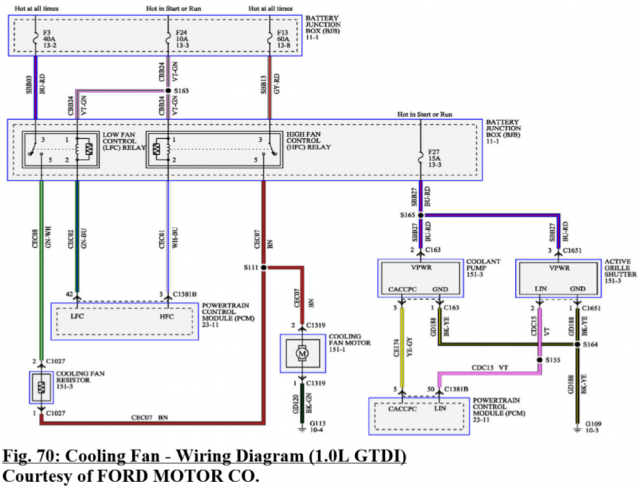

In some Fords using 3-cylinder Eco-Boost, turbo, and larger 4L and V6 motors of 2.0L displacement and above in size, they also provide a "low speed" fan that runs more and takes the heat off the engine and radiator when the AC system is working but not supplying cooling thru it's compressor running. This helps to lower the heating load and the latency issues that can happen when engine blocks and the cooling system in it - try to equalize the temperatures in the block and cylinder head - the cooling fan helps to carry that heat away so the lower limits of the engines efficiency power curve. This can prolong the life of the motor and reduce the over temperature heating and fluid boiling issues that may occur and damage the system if the engine just ran the Fan at a higher pre-set temperature limit it would use in cooler weather - this upper limit switch setting being applied all the time would make the system cycle and possibly put the engine block to cylinder head seals at risk of excessive overheating and boiling conditions caused by the wider variances in cooling system pressures.

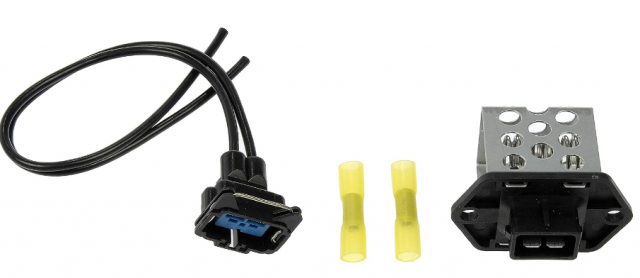

If you can be creative enough, you can take the above diagram and make a similar system using a manual switch to bypass the relay portion and just run a Power Resistor used in a typical FORD V6 Fusion / Mondeo / Taurus Radiator shroud. It is a simple wire wound nichrome wire Coolant Fan Resistor it's a Dorman Part 902-219 - comes with a Pigtail so you can then interleave it into your harness.
You also don't have a "low speed" resistor - for if you are not using any 1,0L ecoboost motor - the vehicle has no relay or part for it. The "low speed" resistor is only meant for the Eco-boost motors and they are 3 cylinder turbos on top of that - so the extra cooling parts added into the Fan circuitry is what drives the efficiency of that design.
So if you can still find one of those Dorman 902-219 dropping Resistor kits, go for it. This can be set up to run the Fan on a low-speed rotation so it's not so noisy when it is doing it's job, then the system is cooled down to make the AC exchange more effective when the AC kicks on.

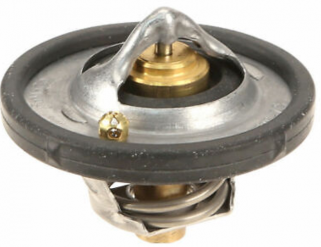

Else you'll have to remove the Thermostat and bend the Piston V - arm that works the wax-plug/piston seal - pushing this "arm" into the seal / rod area - moves the Seal down - releases the coolant earlier for the Wax plug only moves so much per degree of temperature in which the wax beings to melt. So it will open sooner, keeping the engine running cooler because the coolant can start pulling the heat out sooner - which can help keep the car cooler from producing less heat - but be warned you'll have to make a judgment call on this cooling system temperature change - for it can set a MIL Check Engine light because the system is not getting "hot enough" per the emissions - just re-bend the V-arm bar back to it's peak to force the wax plug to stay closed longer.
