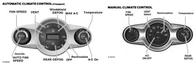

Works when it wants to?
Might need a new controller - but that depends on the type of climate control system you use. Manual or an Automatic?
Manual may have a simpler design but the Automatic ones use a lot more wires and are harder to fix due to so many sensors and the way it has it's fingers everywhere in the system.
When the blower comes on, that is a good sign but how or why is that affected by the Engine cooling fan? They're on separate circuits - you mentioned hard wired, so we can only guess...

It is a 5spd manual.
