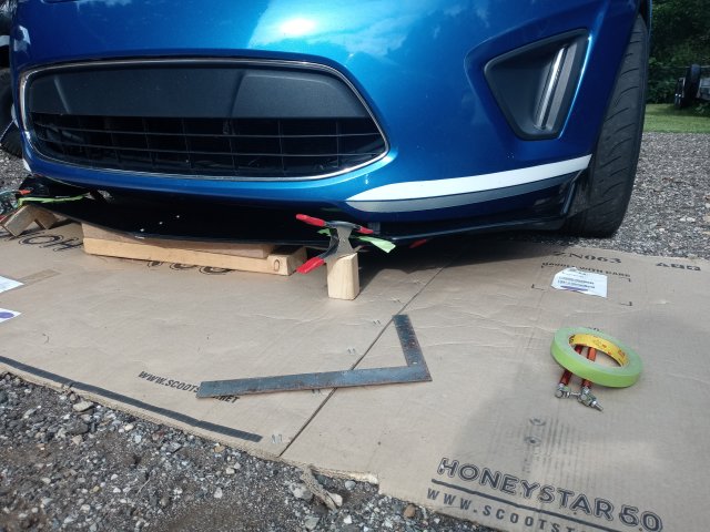

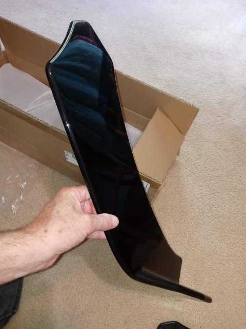

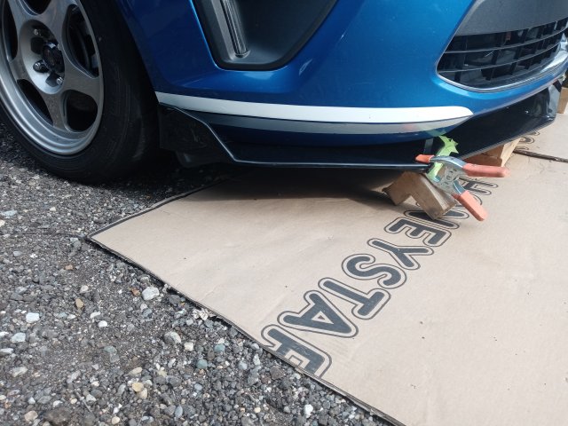

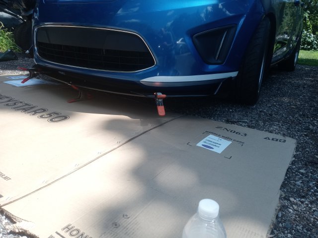

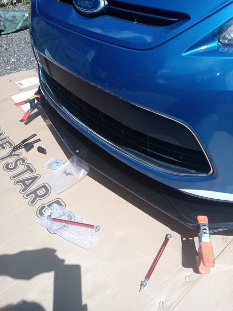

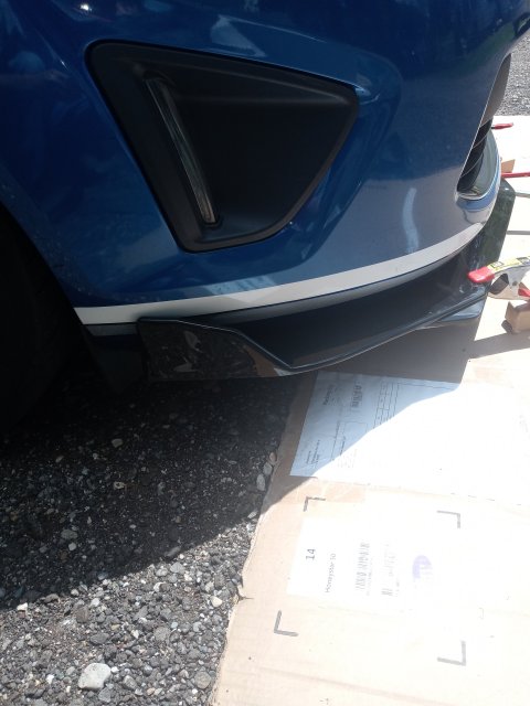

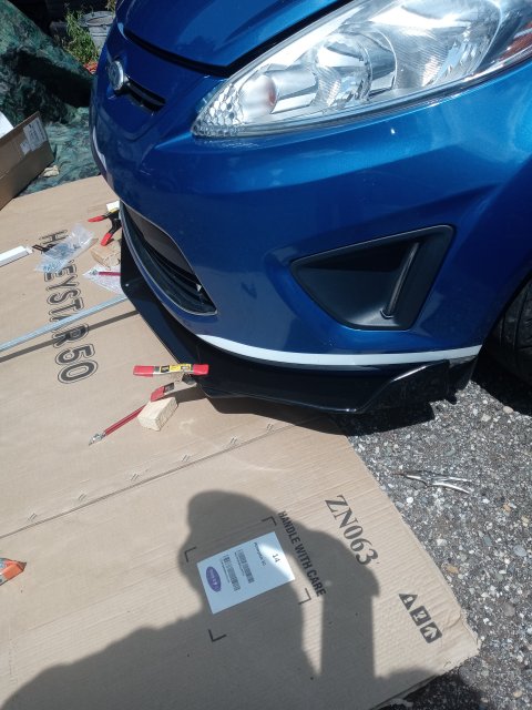

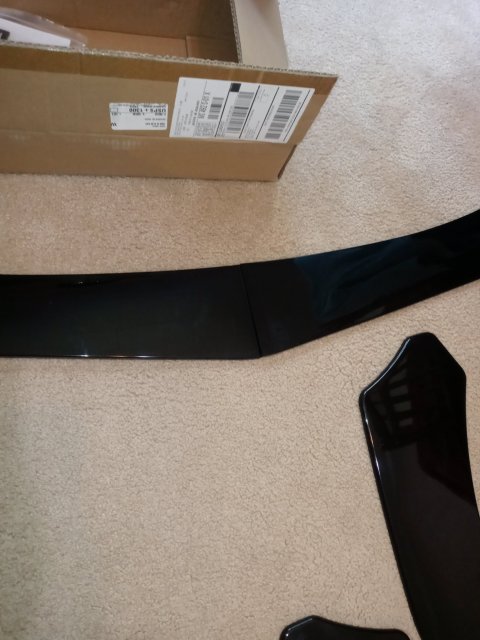

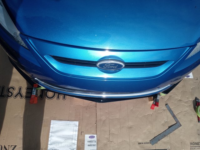

I'm just confirming that i can actually fit this onto a 2011 Fiesta. I am not sure if I will use it. This design has many more parts and hardware than the custom tailored one. A few images of the unboxing and then a few images of the parts clamped and supported in place, minus the red adjustable uprights. I am trying to get a good idea of how it will look. I can understand why the uprights are needed once I had the splitter positioned.this one is from Linkterest on Ebay. What do you guy's think? unnamed.jpg unnamed.jpg 20220731_173554.jpg View attachment 6800 View attachment 6800 20220802_142600.jpg 20220802_142622.jpg 20220802_140639.jpg 20220731_173716.jpg 20220731_173631.jpg 20220802_123048.jpg

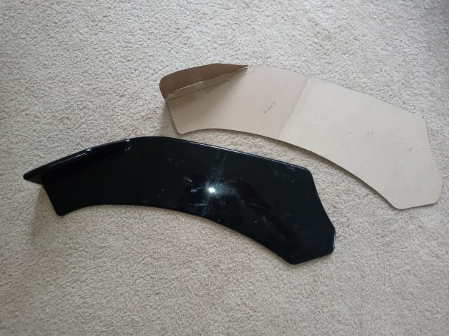

These images are of the parts being fitted "as is" out of the box. I will post pics of the trimmed fit. The 11 to 13 Fiesta has a lower airfoil that i will have to trim the mounting surface of the splitter back about 1.5 inches to give the space needed to get the winglets moved back to the edge of the bumper cover.
This one has a lot more mounting brackets and hardware than the one that we bought! The only reason for the delay in fitting pictures of the one I have that is identical to yours is he decided to get the oil change i offered over money. His 2018 Fiesta isn't due for an oil change for another 3,500 miles. So i'm waiting.

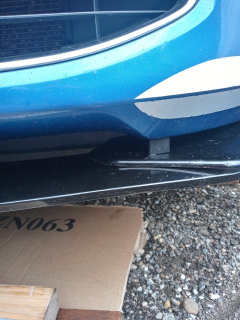

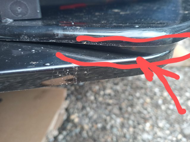

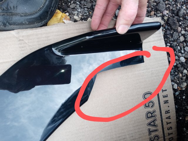

I did some careful trimming of the winglet panels. They had to be notched a bit to allow the clearance needed to move the splitter back enough to not protrude as much. Which is a concern because of the increased exposure to hitting "things" that a low mounted and protruding component presents.the range of adjustment is wide. But, once I had it where it looked right on the car, the overlap was awkward looking and needed some reinforcement aluminum added to the undersides in order to have the combined parts have some decent rigidity. It is definitely not a simple and fast kit to add to fiesta. 20220803_093839.jpg 20220808_115637~2.jpg 20220812_175205.jpg 20220812_175150.jpg 20220812_175857.jpg

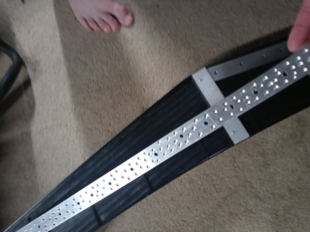

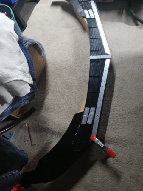

I will post pics of the underside of the bonded splitter as fitted. It's clamped together waiting for the epoxy to cure.

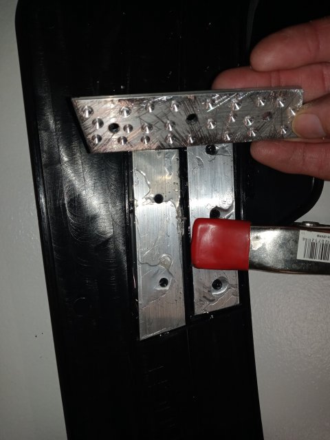

A few images of the painfully slow process of fitting and gluing the reinforcement aluminum strips onto the underside of the hopefully soon to be less floppy splitter. 20220818_135010.jpg 20220818_135027.jpg 20220817_203751.jpg

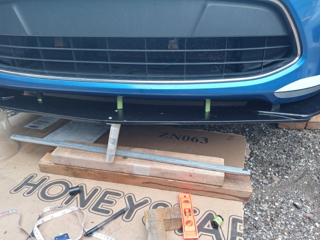

Just determining the attachment points and leveling now. I added three 9/16 x 1.5 inch black nylon pillars that have 1/4 inch drilled through holes for the stainless steel bolts and nuts.

One thing I discovered that was kinda screwed up was when i epoxied the winglet panels to the center panel the glue flowed to an area at the front of the winglet panels where it meets the front edge of where both panels meet. Being inverted, i didnt or couldn't get a good look at what the panel gaps looked like post glueup. Fortunately both sides are almost identically imperfect! So, hell no im not going to attemp a fix. 20220820_141326_HDR~2.jpg

Thanks! I decided to try to dodge the rain showers and get the mounting points done. It looks and feels like a more substantial part than it was a few days ago.
It looks much better after the fitting and fettle sessions!.
I think the final word on this piece will be something like " what comes in the shipping box is just a skin for what you will end up bolting onto your bumper". In any case, i humbly accept the applause from the most interesting man in the world.
