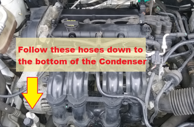

The pressure transducer is a SINGLE sensor - with three terminals - one for too low, one for too high - with 3rd as the constant power to it - so it's dynamic and located near the lowest portion of the system where the oil and fluid portions of the Freon are at rest.
Since it's pressure - the balance of it, the sensors are equal in response.
When too low, or too high in pressure, it upsets the balance one output rises - the other falls.
The PCM uses this information so the system can perform in a wider variety of environments without "Freezing" or boiling the system like earlier days that use just a set level and there you go, if it ices up - thaw it out, if it doesn't produce enough bring it in and we'll fix it - by evacuation and recharge
The Sensor is located at the Radiator - Lower Right side - in the condensers "dryer" section - on the bottom.
Find the long tube next to the condenser and follow it down to the bottom of it - the tube that comes off it to the compressor, that has the sensor.
