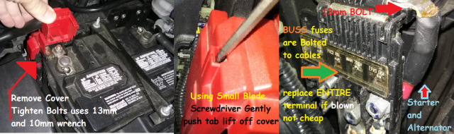

But also there is the battery terminal (red covered one for positive) is a set of "buss" fuses that are "bolt in" types.
IF they had tried to start the car, you might need to check these "BUSS" style fuses that run off - from the Red Cover Terminal. There is a tab for a flat blade screwdriver to pry the tab so you can lift the cover straight off - exposing the fuse links - if they are blown you may need to replace that battery terminal as one unit - it's not cheap . But it prevents your car from starting - even though the main charging/Starting cable is ok , won't engage the solenoid if the other fuse links are blown to protect from drive offs.
That is a worse case scenario but it is also one you can check easily enough to see if they are intact. IF they didn't put all the cables back tight, heres your answer - a loose unclipped cable connector or bolt can make your day.
Otherwise you'll have to locate the other Fuse block locations - one in the engine and one behind the glove box - for more blown fuses or pulled relays.
