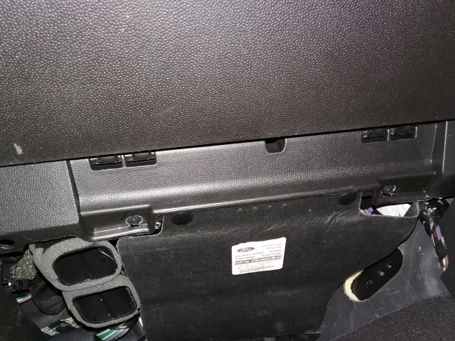

When you lose Bluetooth Phone and the USB, those "interfaces" are on the SYNC board, located under the Glovebox - fitted inside a little flat black box - if that is missing, you don't even have sync - that is the sync support unit and also is used for TPMS because it has the BT unit that is frequency compatible to the TPMS units in your tires.
To find your SYNC USB BT unit - it's under the glovebox, hidden behind the "Hush panel"
