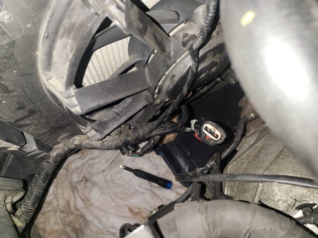

I've tried just about everything replaced the thermostats , and temp sensor, relays and fuses. Checked wiring with multimeter, bought a separate relay and my fan has two plugs I have a relay with a 40amp fuse and 40amp relay, that has a switch with a red and black terminal that I've hooked up to both the low temperature ac off input and the main motor input, tested output of the seperate switch it's outputing 12v, fan still won't power on.

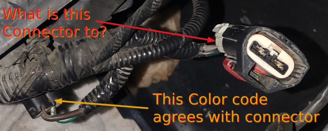

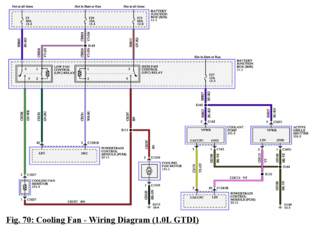

I was able to find a wiring diagram for the Ford fiesta ST, and this proper schematic for the 1.0 EcoBoost. But I don't get why it isn't turning on, I had it taken to my most trusted mechanic and he had tested the fans supposedly and told me not to buy a fan because it wasn't the problem but now with the separate relay hooked up with the red and black I am not able to get it to power on, I'm curious if there's something I'm missing as if I'm supposed to keep the main pigtail harness hooked to fan and hook in the red and black into the male adapter on the pigtail instead of the female adapter located on the bottom left portion of the cooling fan or the main fan female terminal on the motor.

The Cooling Fan - you have one, but it uses the TWO relays. One for Cooling and One for AC they operate it, are also interconnected. One is for the Engine Temperature and then the other one is for the AC which may also contain a dropping resistor located in the housing over by the condenser core and water filter (larger long cylindrical vertical tube) used to collect the refrigerant and help precipitate out water before it gets squeezed thru a valve and orifice to generate the cooling expansion needed for the AC to work.
The Cooling Fan uses a ground lug - over by and under the Battery - it is bolted onto the frame - on the LEFT side - bolted to the engine-side (inside) of that wheel-well housing. IF the Ground wire is corroded - or the shroud is damaged - both can be keeping the fan from spinning. This jamming and poor connection can keep both the AC and Cooling (overheating) fan from even starting.

There is more to the Fan control - so if you have issues with the AC - the ENGINE Over-temperature (Cooling Fan ON Relay) condition should work independently of the AC system - but if the COMMON Ground lug used to complete the circuit to the Fan is bad, or the FAN Motor Module (Dropping Resistor) is bad, or, and worse case, the fuse to power those relays a simple 10Amp (F24) is bad - then the motor doesn't work at all - so do you have a two wire Red/Black connector? (Photo shows something else) So that means you have found the Fan connector - but you will have to dig around the shroud and make sure you have all the wires in that loom (on the shroud itself) still interconnected. That Red wire can get power from one of these relays - even both at the same time - just not all the time.

You do know, that back at the Battery Junction Box (The High current side of the main Engine Bay Fusebox) , you have several fuses F3 - 40A (Low-Speed Hi-Amp), F13 - 60A (Hi-Speed Hi-Amp), F24 - 10A (Relay power) which Powers Relay R5 and R7 (Emissions branch to PCM) and F27 - 10A (Active Shutter - Coolant Pump)
But you will have a separate harness to the fan shroud to handle the dropping resistor which routes (loops) back as the (READ: Your) RED wire to the Fan connector, and from that loom, even have a branch off of that to go to the Active grille shutters. Remember I mentioned that the Dropping Resistor that gives the Fan Low-speed - speed, is also mounted in the shroud.

Just not sure which one of these connectors are the ones that are OEM. One on the bottom agrees with the schematic. But the other one left open in the photo - where did that go?
You may have struck something under the vehicle or rolled over some debris that can affect the integrity of the wiring.
