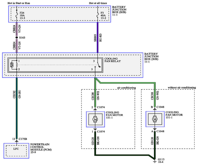

Car with Ordinary Cooling Fan Motor
(note color code and that the FAN uses a 2-wire connector)

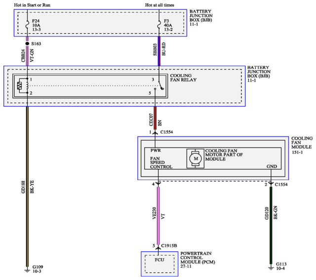

Fan with FAN SPEED-controlled Module
(Note: Color code and connector has 3-wire and USES A 4-Pin Connector For INDEX)
Did you have a chance to verify that the FAN connector can even get 12V from the Relays' socket that sends power to that fan? In both diagrams, that 4-PIN connector uses PIN 1 at the Fan to supply power. The 2-Pin Connector uses the PIN 2 as power - so if your not sure of the polarity of which way the connector is wired, check both pins on that 2-Pin connection.
4-Pin connector? Test this using Pin 1 on the Fan connector Harness side back to the Relay PIN 5. The results of that, if it fails the continuity test, is a harness issue and may thread back to a spot under the battery that has a cover on it that keeps the batteries acids from eating at it.
Else if you have a 4-pin connector - the PCM is not sending a signal to it, which may mean you have to replace a sensor located in the cylinder head of the engine. It's by the centerline where the Transmission meet's the engine and is by the Coolant OUTLET hose that goes both to Heater/Climate Control and to the Radiator - right by the ignition module.
