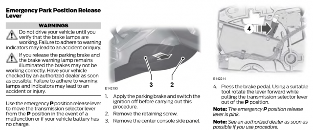

So if you can get it to "light up" but not start, then either the PARK switch is broken or the parking PAWL that takes up the park (locks the transmission) may not be fully engaged. There is a small indentation on the PRND2L shifter base side panel pull that panel off, get access to the "pink" lever - that if you can pry that over to one side, the shifter can then be pulled into Neutral and you can try to start it from there.

What I have researched from this...
When that happens - a lot of times the DCS didn't "set PARK" gear properly.
So if may need a little help from you --- you may have a low-charge remaining battery condition that once the engine is shut off - the Brake Solenoid that is supposed to allow the Shift lever to release - you need to keep the KEY ON - even use a battery charger - to supply enough power to allow the solenoid to disengage the parking "PAWL" the parking gear is - to bring the lever into neutral to allow you to start the engine - to finish clearing the condition caused by low-voltage.
That is if the ABOVE Post - after everything is done - can't release the transmission from PARK.
Use the Emergency brake as needed to "HOLD" the vehicle while you attempt to release the pressure on the parking PAWL - it may even need the vehicle have to be rocked gently back and forth to help reduce the locking torque - which is helped by keeping the KEY to ON - to let you use the Brake pedal in conjunction with the Emergency Brake Handle - press and hold the BRAKE Pedal not all the way to the floor - just enough so you see the rear brake lights are on - then try to adjust the shift lever from Park to Neutral - then apply the Emergency Brake (that handle) to keep the vehicle from rolling away you should be able to now get it to start.
