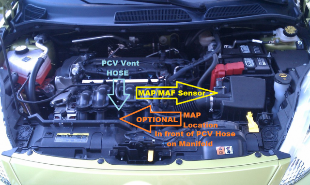

Hmm, ok, when you replace this sensor, your 2012 has two locations it may be at...one, on the Intake Snorkel, while the MAP (combined MAF POST 2014) sensor is on the INTAKE manifold, and it's by a hose that arrives to the INTAKE MANIFOLD from the PCV oil ventilation valve..
The MAP and MAF go hand in hand.- while if one gets replaced but the other doesn't, or that other one doesn't even get looked at or cleaned up - it will not be able to "Track" your throttle and air temperatures, flow as well as be able to provide any means to offset torque or RPM, or even acceleration and other kinds of stuff You need the engine to do - "...if one works, great! But I need this too..." - sort of thing is going on inside your PCM hard to make it work without all three working simultaneously
Your 2012 should look like this under the hood.

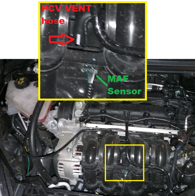

I own a 2018 - but that uses a COMBINED MAP/MAF sensor located on the Intake manifold.
It's right on the intake - see that connector dropping to the bottom of the photo - that is a MAP/MAF combo sensor there - you may have a sensor there that may need to be cleaned.

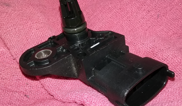

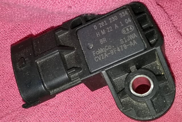

That little guy has 1 screw Torx-20 holding onto the manifold, it should look like this...
May be slight cosmetic diffs but are similar - the number may be different but this sensor and it's location is where you need to look for - remove it, and clean it up check the connector and wiring harness to it too, that can set a similar train of codes because it doesn't communicate anymore or its connection to the harness is intermittent.
