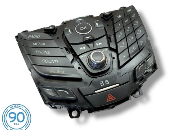

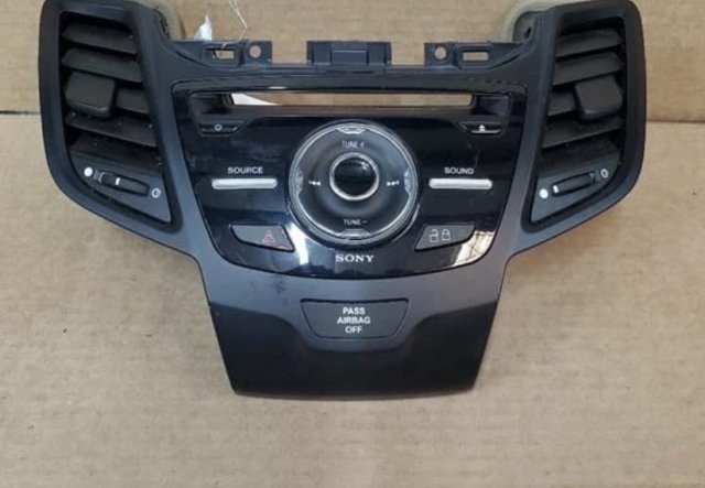

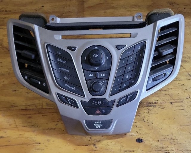

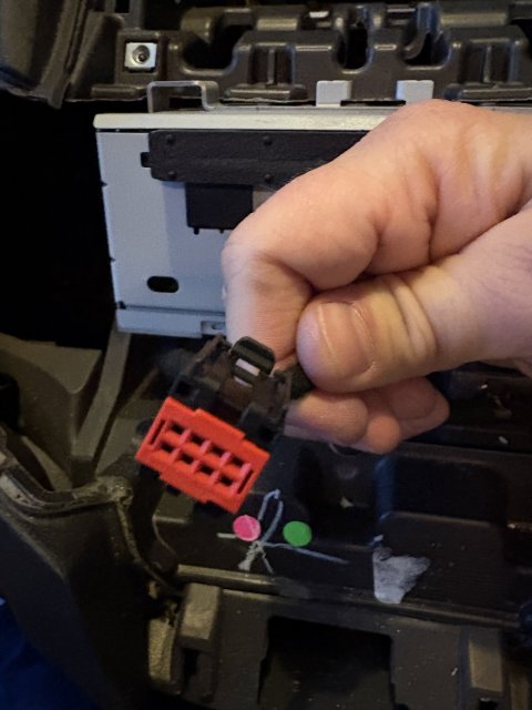

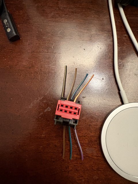

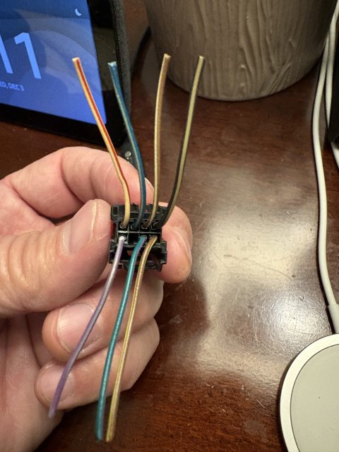

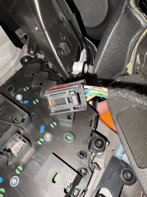

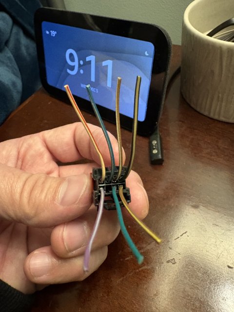

I have a 2011 Fiesta SES with Sync and am going to replace it with an Android head unit. Since I won’t need many of the original radio control panel buttons (for example Sirius button), I wanted to swap the button panel with one that was used for cars that had Sync 3. I tried the new panel prior to connecting the new head unit and the door lock and hazard buttons work, but the volume, tuning, source, and sound buttons don’t work and the buttons aren’t lit up. Perhaps the pinouts are different. Does anyone know the pinouts for the 2011 Fiesta control panel and the newer control panel pinouts for those that used the simplified panel for Sync 3?
Thank you, in advance, for your help. Here are some pics…
