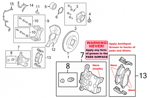

1,835
1,540
Nice exploded diagram. It's even specific to the Fiesta!

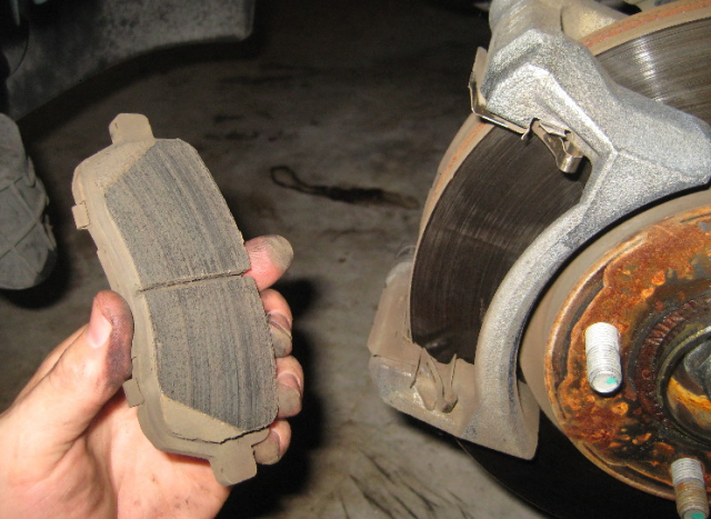

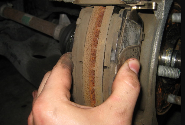

Interesting thing about those pads (or any of the Front Caliper types really) they have a "wear indicator" that shows the depth of the groove - when they are new - then the pads wear down, that groove gets shallower.
Pretty soon it's gone - then the media the pad is, is all that is left.
So when you compare ... the newer the pad, the stronger (deeper) the groove is and so is its media - that actual brake material.
It's when those pads are flat and no groove left in them, should they be changed or even messed with.
You can review them by not even removing the caliper, but if the wheel is off, why not look them over?
Look for Even wear on both halves - one wearing more than the other? Then should you start to worry.
